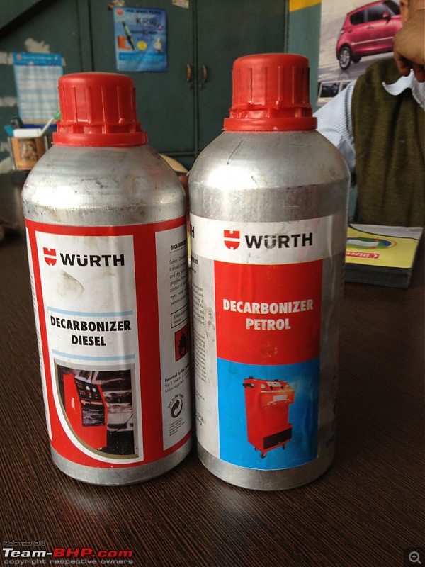

At the outset, let me clarify that this post of mine is not promoting somebody or some product or services. I'm providing an information that I feel could be useful to the members.
My FNG (friendly neighbourhood garage) Rakesh of Rakesh Motors, Gurgaon has installed a decarbonising machine in his garage for both - Petrol & Diesel. Uses products from WURTH.
Today when I was there, an Alto came for the same. The engine was shuddering at idle and I said that maybe the foundations need to be replaced. But I was wrong.
After decarbonisation, there wash't even a vibration from the engine and the sound too had changed. A 10-12 minute job.
The charges for decarbonisation is as under:
Petrol - 1k
Diesel - 1.5k
Decarbonising machine
Mahindra Scorpio : Issues & Solutions-decarboniser1.jpg
WURTH solvents
Mahindra Scorpio : Issues & Solutions-wurthsolvent1.jpg
Alto being decarbonised
Mahindra Scorpio : Issues & Solutions-decarbonised1.jpg
Mods - if this thread doesn't belong here, then please move it to appropriate section
gd1418 is offline   (2) Thanks

I went to Rakesh Motors and luckily met GD there.
Got the Scorpio decarbonized for Rs 1500 in 30 mins.
There was a little less smoke from the exhaust and a slight reduction in sound from the engine.
