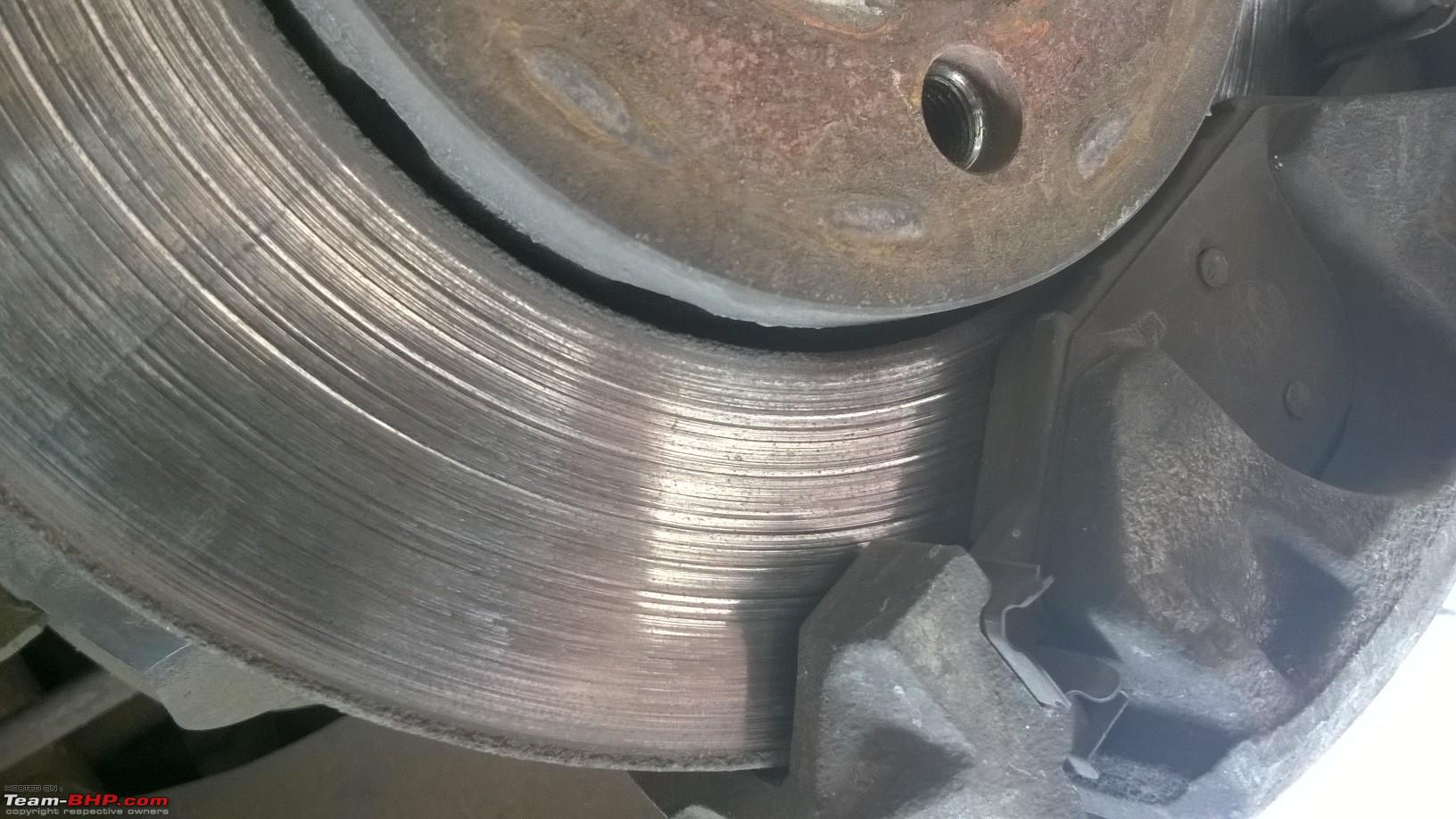

My car has completed 50K kms. Got the tyres changed yesterday, and was a little surpised looking at the brake discs. I can actually feel the abrasions on the brake disc with my hand. I have an i10 which has done 60k, and the brake discs are still smooth.
I am also hearing a slight humming sound from the left front wheel. It can only be heard while coasting in 4th gear, as the TDI is too loud and drowns everything out other times. Looks like the brake pads are rubbing against the discs. The VW SA says he cannot hear anything when I took him on a test drive.
I jacked up the car and noticed that the right wheel can be turned quite easily as gainst the left wheel, which takes quite a force to turn manually. Any idea what can be done to correct the brake rubbing? Can I get this done outside?

Old 20th September 2015, 13:27   #854
Join Date: Oct 2011
Posts: 12,345
Thanked: 21,452 Times
I have had the same condition in my Karizma though so all I had to go if change the Disc plate and disc pads. No point in changing brake pads as the Disc plate is gone.
AFAIK, the humming sound could be shot wheel bearings. Does the sound increase with speed?
