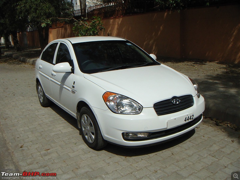

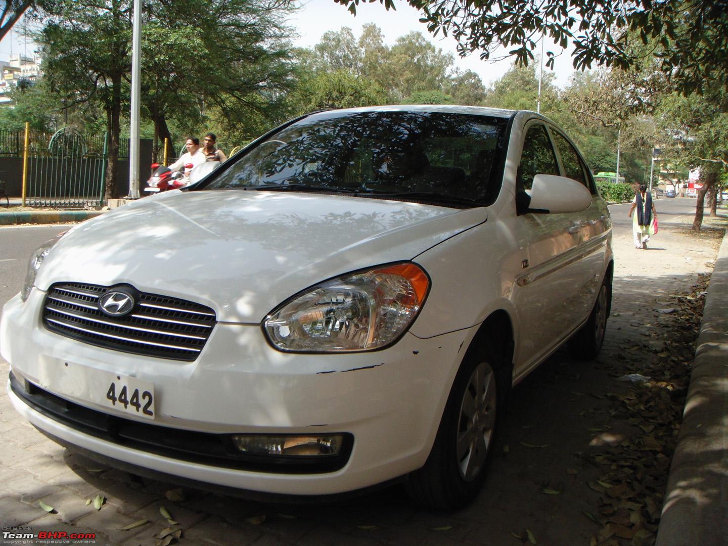

Another Batch Of Pics

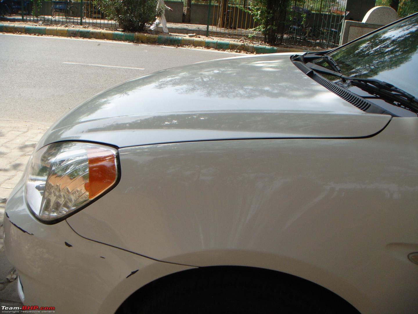

Clay just lifts off dust and debris that is stuck to the clearcoat!
to make the paint surface 'smooth as glass'!
It doesn't affect the clearcoat!
Rubbing compound abrades the clearcoat to attain a uniform finish
(uneven clearcoat = scratches/swirls,
even clearcoat = perfect finish(attained by proper use of rubbing compound))
As you see in the below pic, all the scratches and swirls are un affected by the clay, these are removed with SwirlX/ScratchX/UC depending upon the severity of the defect!

@Notoroius
Good job on your car. It looks really fabulous!
