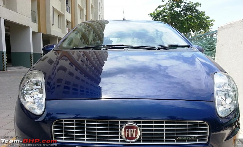

Meanwhile, this is what I had been doing in the past week.
On tuesday and wednesday of this week I finished detailing the rest of my car . Here are some more pics:-
First, the roof and the rear spoiler. Used @Notorious clay and Meguiars QID as the lube. The clay was great, pulled off a few contaminants since it has been almost 6 months of my previous detailing.
Used the Kestrel along with orange pad and 105. Hardly needed to use a second step, but I did the 2nd step on the entire roof with Ultimate Polish and to me it felt fabulous. My roof was the most heavily swirled part of the car, and looked pretty ugly under night lighting in malls and in parking lots. I was really impressed with the power of the simple machine.
In the last few pics, I've tried to capture the 50/50.
A few after pics after applying Megs NXT TCH 2.0 sealant on the roof. Crisp reflections.

Originally Posted by Parthasarathig View Post
Some after pictures of the doors with Megs NXT TCH 2.0 and Collinite 915 on top. Enjoy the crisp reflections.
The results on the hood are pretty good man! The last 2 pics, with the Pulsar bike in reflection were also a before/after comparo ? Do post more info on the Megs NXT 2.0 sealant. I always thought they only had it as a paste wax.
