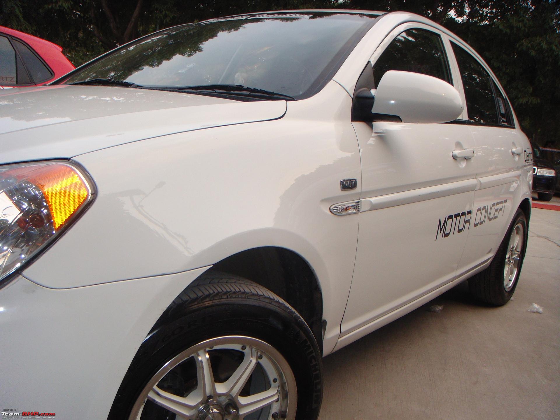

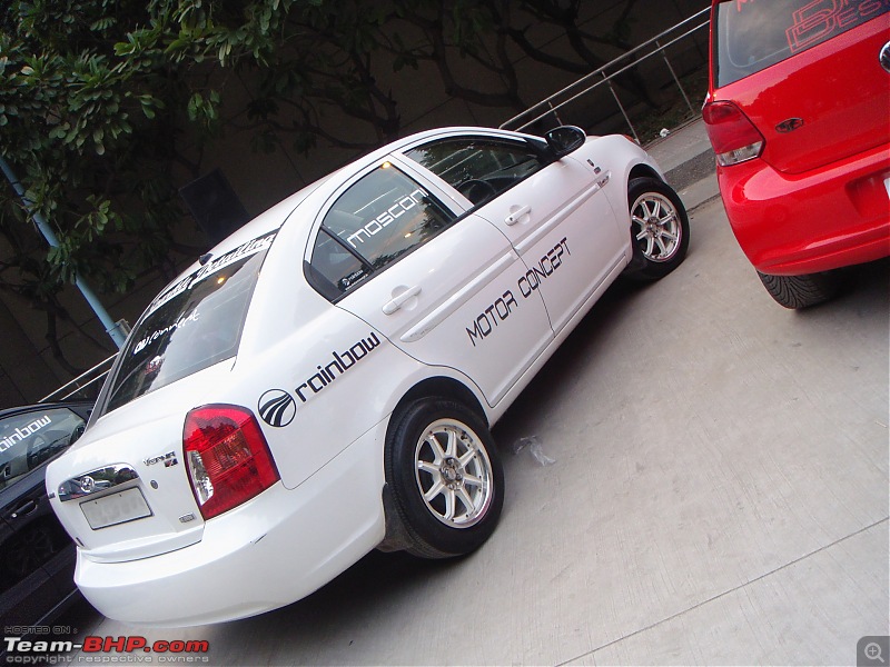

Here Are Some Latest Pictures of My Verna !! Hope You All Like It !!

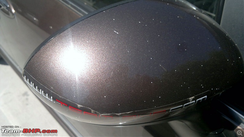

Guys, need your advice. My car was parked in open and someone somewhere was whitewashing his wall. In the morning I noticed a heavy over-spray of calcimine on my car's front bumpers, hood, side mirrors, windshield and front half of roof. Luckily I woke up before the car cleaner could scratch it out. Took it to a professional car cleaner and as per him claying won't help, and they will have to use rubbing compound. I got my car rubbed and waxed at the same place last month so, he asked me to wait for a few days and then bring the car back. I am not too inclined on getting car rubbed so frequently especially because it's a dark coloured car (Bronzo Scuro).
What do the experts suggest? Is there something I can do at home or shall I take it to another competent detailer (on the other side of the city)?
Pics of the over-spray:

Try out a small area with mild dose of turpentine or diesel.. Something slightly acidic like diluted vinegar may also help.
Paint drops may not be that well embedded if your car still has any polish/wax coating left from your last treatment. Try removing one spot mark using your finger nail. If it comes out without much issue, you can safely go for clay treatment.
Rubbing compound nowadays comes in various strength. Light application wont do much harm. But of course, that's the last option.

Don't think any of these going to work. No harm trying out though.

If you let it sit for a long time, it will bond with the paint. Then your in trouble.
Best option would be just hop into a 3M store and request them for spraying the patch with all purpose cleaner. It will remove it easily. They may charge nominally but if you opt for a wash then they may not charge for removing the paint marks.
Don't use a rubbing compound. I had tried it once but it actually spreads the paint into the clear and leaves a mark. No rubbing stuff should be used.

I faced the exact same situation last week and claying took care of every single spot of overspray.
After claying, you should polish (if required) and apply a fresh coat of wax / sealant.

Read about the diluted vinegar on another forum as well. Will try it next time (god forbid).
Thank you Mr. Sen for the guidance as well as editing the post. Luckily, I applied a thin coat of wax on Sunday. In the morning, I sprayed Meg's QD generously over the spot and then wiped with a MF cloth. Some of the spots have gone but the bigger ones are still there. Tried removing one with nail and it does get removed. So, clay treatment is in line.
How I wish there was a 3M store in NCR. There is a very reputed detailer (Authorised by Meguiar) near Gurgaon and I plan to take my car there tomorrow.

Hope claying helps in my case too. I had all the detailing stuff at home except clay bar . Have placed an order now to ensure that next time I am better prepared.
If the finger nail works, it might be the best way to do it? But I guess there are a lot of spots, and you might get very fed up.
I'm thinking razor blade, but I'm very reluctant to say it, because one would have to be sooooo careful, keeping the blade flat and just touching. Reminds me of the day that I removed a spot of hardened epoxy glue off the lens of a new pair of spectacles. Very scary, but yes, I'm wearing them now and there's no scratch. That was kill or cure, though: they would have been useless with the glue spot. They were ruined: I could not ruin them any more, but there was a chance I could fix it --- and it worked out.
OK, so yes, better not to use a blade (unless your day job is brain surgery ) so how about something that should not scratch paint. Raid your kitchen drawers for the softer plastic things that have an edge. Use lubrication: Quick detailer or even soap.
Example: I have a broken toothbrush handle that broke to a roundish, quite-sharp edge. I find gunk builds up on the chrome radiator grill. Actually, the handle broke while I was trying to brush off the gunk, I looked at the broken part, though Hmmm... and yes, it did a good job with no scratching.
Whatever you do, try on an invisible piece of paint first, like inside a door frame, to make sure it will not scratch.
These are crazy ideas. Please accept them as such and feel free to dismiss them immediately. Sometimes a little improvisation and ingenuity can save the day --- and sometimes it can ruin it completely. Take care of your paint.

Spray it with WD 40 and then lightly scrape of with your nails wrapped in a thin soft cloth. It worked for me when something similar had happened
