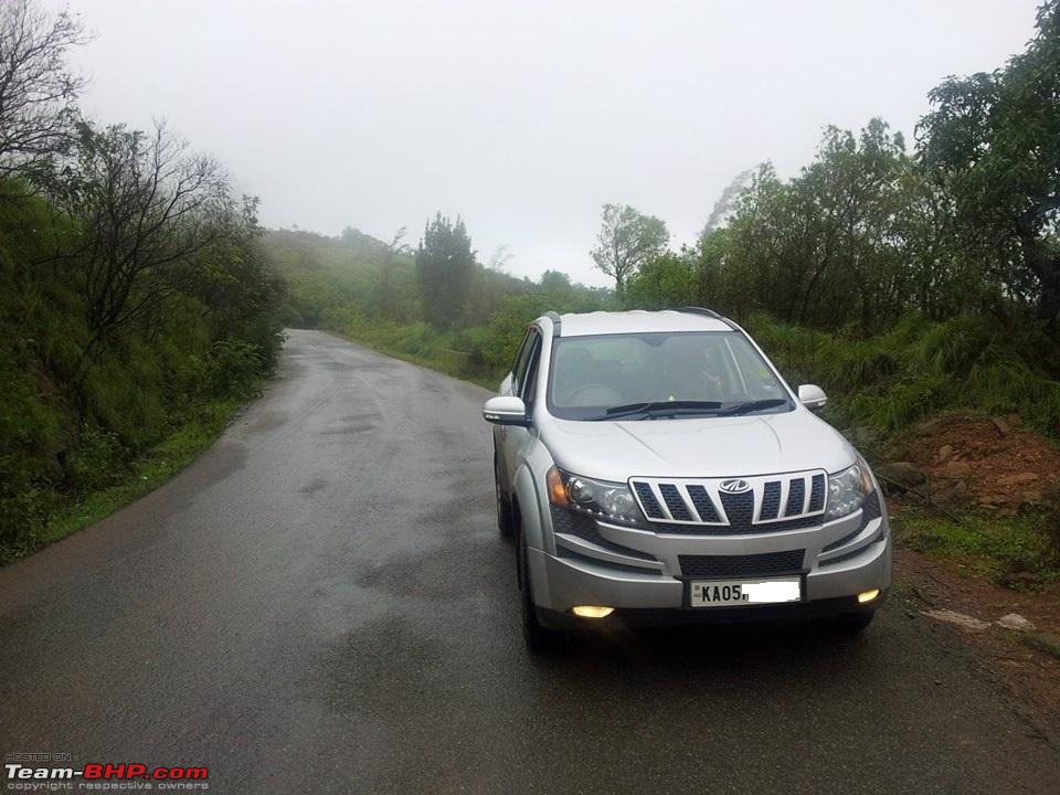

Hello All,
I drive a Silver XUV W6. Its a Feb 2013 Model Vehicle and has run 8000 Kms to date. I would say half of it on Highways and Western Ghats.
The present Niggles Observation List:
1. Initially Front left side Suspension or some neighbouring part gives a muted "thud thud" on bad roads when the suspension acts.
Resolution Attempt: 1st service, this issue was reported and got the feedback that a screw was not tight and thought the issue was resolved.
But realised later that, both suspensions in the front gives that noise now on bad stretches.
Note that, it is not very audible or irritating. But I need to know, how serious an issue it is. So that it can be taken care on warranty.
2. My 1.5 yr old son did a pull-up on the Internal Driver Mirror. And the whole assembly came down broken. Now, some sensor assembly which resides below the mirror assembly is visible in open.
(this isn't a niggle though. But need to get it repaired or replaced)
3. Middle row left blower stopped working.
Resolution: 1st service, replaced the vent assembly on warranty. The issue was, the rotating part wasn't internally opening the vent and hence no air flow.
4. Bluetooth connectivity is SOMETIMES an issue and doesn't connect to my Samsung Note.
Resolution: I then, search the Bluesense from my Samsung Mobile search and connection from Mobile end, instead of waiting for Bluesense to find my Mobile (when Mobile is made visible).
Other than above, the Vehicle has run pretty well these 8000 Kms.
* Upgrades Planned: Hella 3003 Pair to be fitted in the next couple of days.
* Upgrades done: Imperial Leather (Nappa Leather) in Bangalore custom stitched and fitted for all 3 rows for 16,000 Rs. And Steering wheel fitted with Black Pure leather.
