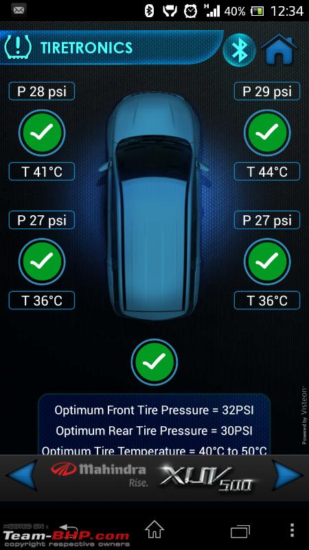

Originally Posted by djpeesh View Post
Here's a screenshot right after I checked my tyres. As you can see, the pressures are all over the place.
Attachment 1117922
Im pretty sure that its not a fault with the app. My money is on the TPMS software or worst case the TPMS sensors itself.
Attachment 1117922
Such minor variations in tyre pressures do exist and is safe.
