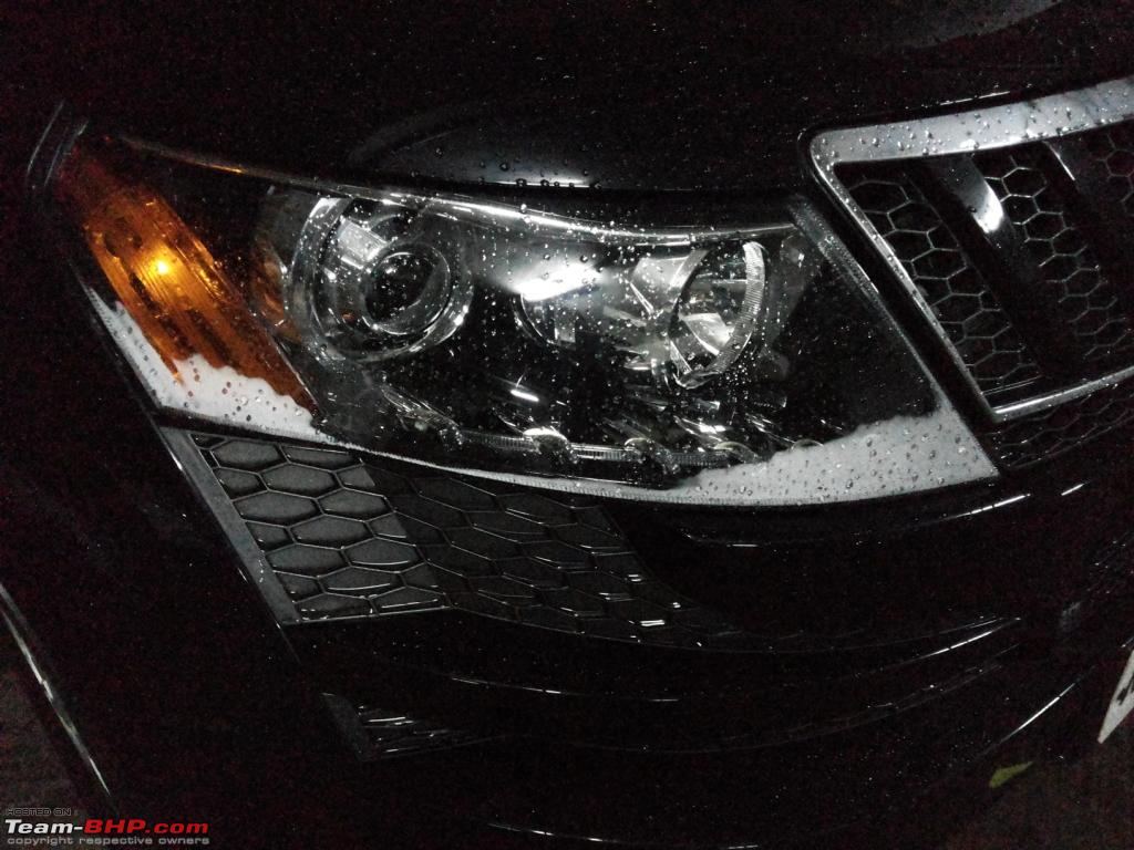

Last month while driving to Goa in the rains when I stopped at a hotel for lunch I saw that both the headlights had fogged up, see attached pictures below,
so when I returned from the Goa trip I called up the Works Manager in NBS in Mumbai and told him about it, he said not to worry and that he would arrange to get them replaced, he was kind enough to send his guys over to my place who replaced both the head lights under warranty as my vehicle is only 6 months old and done about 7300 kms, I am very thankful to him as it saved me a trip to the Workshop in Sewri.
Today evening being a weekend we decide to drive over to Dara's Dhaba for a good dinner with my relatives but fortunately or unfortunately it rained heavily and when I parked the car at Dara's Dhaba I was shocked to see the new head lights fogged, see below,
Has anyone had this issue with their XUV's during the rain? I will be calling the Workshop manager tomorrow morning and see what he has to say.
Both headlamps fogging up at the same time seems highly unlikely as both are independently manufactured units. Since these are sealed units and ingress of moisture is normally not easy, there might be a possibility that these were improperly installed/fixed during replacement of your original set.
I would suggest that you ask the service centre personnel to do a detailed root cause analysis and not just blindly replace the whole units like they did the first time or else the same problem would recur. Have you installed any HID bulbs or any other modification has been carried out to your lights?

Originally Posted by Sisu View Post
Both headlamps fogging up at the same time seems highly unlikely as both are independently manufactured units. Did you get a replacement for the strips too when the headlamps were replaced in warranty?
Both headlamps fogging up though unlikely has happened as you can see from the pictures, the new head lamps came with the bulbs already installed so even the bulbs were not removed or switched from the old assembly to the new, all they did was remove the front grille and loosen the front bumper from both sides to get access to the mounting bolts to remove and replace the head lights.
I have sent an email to the Workshop Manager with the pictures who said that he will discuss the issue with their technical team to see what can be done.
Regarding the chrome bezel on the headlights I haven't got those yet but the Workshop manager has assured me that they will be replaced once he gets the approval to do so.

Firstly the xuv headlight is not airtight. Therefore the slight frosting is bound to happen. To minimize the chances of frosting, ensure the rubber cap for both the beams are tightly secured via tape.
Or something more drastic would be to use a oil seal of the diameter of the bulb or rubber based adhesive.
