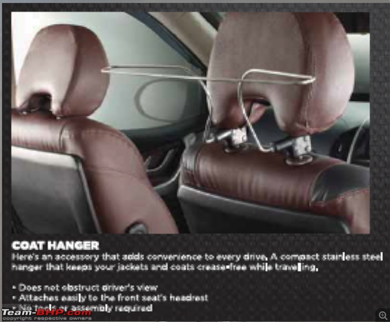

Hi folks,
Since winters are around the corner, the business suits are out. I was thinking to get the coat hanger that attaches itself to the front seat headrest installed. Quite a useful device IMO for someone who travels a lot with his jacket stowed on the rear seat.
Has anyone got this installed in their Cheetah's? Costs around 1500 bucks I guess...
Cheeerzzz
PS: Sorry for the poor quality pic. Couldn't find a better one

Originally Posted by Sisu View Post
Hi folks,
....Quite a useful device IMO for someone who travels a lot with his jacket stowed on the rear seat.
Cheeerzzz
1500 bucks for a piece of twisted wire with 2 clamps? I will pass this tempting offer
BTW, I use the hook on the grab-handles.
PS: I believe the official review thread is a better place for such queries rather than the niggles thread
Hi Sanjay,
It is expensive for what it is, but looks quite cool I think. I always feel the hook on the grab handles is prone to breaking with regular usage.
Posted it here by mistake. Tried shifting my post to the official review thread but could not manage to do so. Would request mods to shift it.
