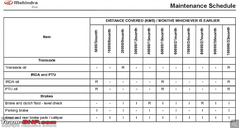

Hi friends
I did get my W8 AWD for the first service on the 12th(after fixing a appointment a week back, 5116 kms). I did ask the SA what were the replacements to be carried out during the first visit. I did do my home work before i did go to the service center, as per the manual (thanks to Heavy Horse), xuv app on my phone, it was clear that engine oil, gearbox oil, PTU oil, rear differential oil has to be changed. ....
Never heard of it.
Can you please share the page screenshot where it is mentioned that the gearbox oil, PTU oil, rear differential oil also needs to be changed in first service?
According to the maintenance schedule, IRDA and PTU oils are to be replaced at the first service at 5,000 km/3 months for XUV 500 W8 AWD.
Attachment 1166897
Ah, this is specific to AWD model. Thanks!
The service staff would have considered it as a FWD W8 and done the regular stuff. This is unpardonable because even after the owner specifically asking for me, they missed it.
