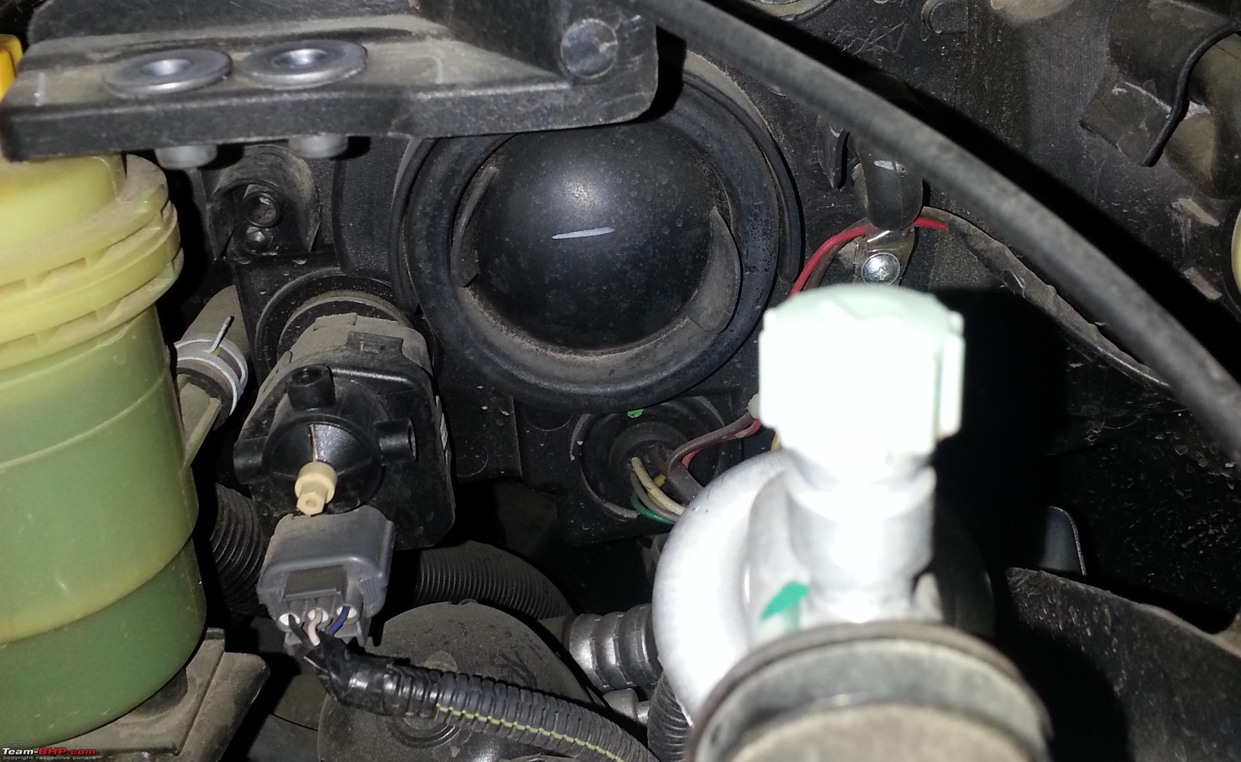

Joined the group with fused low beam bulb. Lasted 5k odd kms. My driver side bulb was gone. Had read here that it is a difficult job to replace it, but I'm DIY kind and have the tools, so decided to have a go at it. If nothing, the experience will be useful in case I get stranded outstation some time. It was not straight forward, but not too difficult either.
First, the 4 bolts holding the coolant reservoir needs to be removed. Did not need to disconnect any pipes, just pushing it to the side gave enough room to work. Good thing is there are no nuts or washers here that could fall off in case you have to do this after dark. (Same is true while removing washer fluid inlet screws to replace high beam bulb)
Pulled off the rubber cap behind the low beam. There was not enough space to stick my head in and observe what I was doing here. So I took photographs using the phone, studied the layout and the work was done blindly, just by feel. The black connector came off with some gentle wiggling and pulling. The spring clip holding the bulb has two loops. I pushed the bigger loop in and upwards and then released it. It took a couple of tries to release it. It then swung away and bulb was pulled out. Just reversed the procedure to fix it back.
The spare bulbs provided by Mahindra are not the same as the original blue one. There is a difference in colour temperature as you can see in the photo. LHS is original and RHS is the spare bulb.

This is a pretty good tutorial. I think I will get a printout and keep it in my car in case I need to replace the bulbs...
So bulb on which side was replaced - left or right? Cos I have noticed during the fixing of the HID kit and bulbs in my car, one side bulbs were slightly difficult to reach. The technician accidentally dropped the spring clip somewhere inside the engine bay while working on one of the lights (LHS if I remember correctly) and had to remove the entire light assembly on the side to finally locate the clip.

FundaG,
This was on the driver side.
Probably the mistake your technician made was to remove the clip altogether. You only need to unhook it from the tab seen on the left side in the picture. The right side acts as a hinge and the spring swings open. There is no chance of spring falling off since it is still attached on one side. Unfortunately I didn't take a picture with the spring in the swung open position. Hopefully the first picture of the clip will help you understand how it works as a hinge.
If you have pictures of the HID installation, please do post it. Did the ballast fit inside the headlamp housing ? Next time, I might go for HID instead of replacing the bulb.
