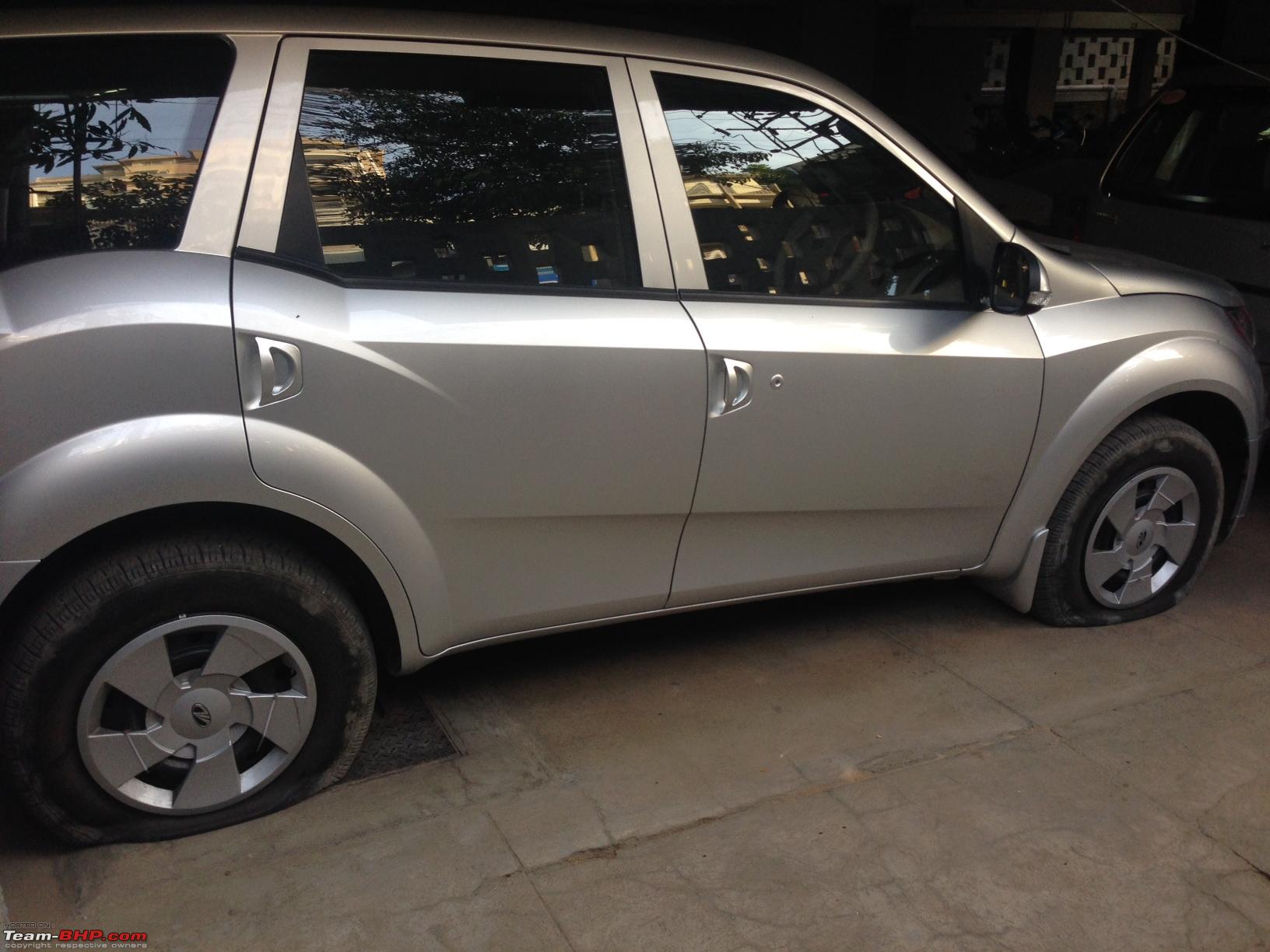

Hi All,
Just wanted to share a incident I faced on the 19th of this month. I has starting for office and I see both the right Tyre s are flat, I went to the puncture repair shop with the tyres and they could find a nail in one and repaired the same. They filled air in them and said they should be fine. But in 24 hrs both the same ones were flat. I went to the India garage Service center at whitefield, after they check, they confirmed that there is a defect and they will replace both the tyre. Mine is a W4, Tyre is from Maxxis and I have clocked 7800 km at the time of the incident.
Photo:
