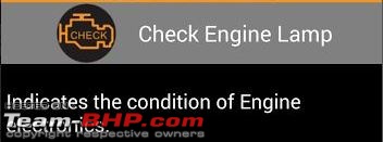

Observed something strange on my XUV5OO last week. On my way back home from work, parked the vehicle in between to buy something. When I got back into the vehicle & turned on the ignition, the 'check engine' lamp was glowing continuously. I tried to crank the engine, but it was silent.
Turned off the ignition and waited for 15-20 secs & then turned on the ignition. Again the 'check engine' lamp was glowing continuously. But this time on trying to crank the engine, it did crank but the engine refused to start.
Turned off the ignition again and waited for a few seconds. During this wait the whole 100 odd pages of niggles started playing on my mind making me think what possibly could be the problem. Finally this time I turned on the ignition & started to gaze at the 'check engine' lamp. It goes off after a few seconds like how it normally does. Cranked the engine and there, he is back to normal as if he barely knew what had happened a few seconds back.
Drove back home & did not feel anything abnormal in the way the vehicle handled after the incident. The problem has not occurred again either.
Has anyone else faced something similar? Anything that needs to be checked in particular? The vehicle is due for second service & I'm planning to schedule it next week or so.

When you visit the A.S.S. ask them to connect the laptop and check the DTC code which would be stored in the ECU. The DTC code would reveal what the problem was related to.
How far back does the ECU store such data?
I had also experienced the same 2 weeks back, gave me a scare, but considering it was mentioned in the niggles before I waited and cranked again and it started. Since then had no such issues again (knock on wood).

I'm not sure about the duration for which DTC data is stored. As far as I know, a DTC code is stored in the memory either till it is manually 'cleared' (using a OBD2 scanner or laptop) or till a certain number of start / stop cycles without recurrence of the fault. You may get some information here.
It would be prudent to have the DTC code identified soon.
