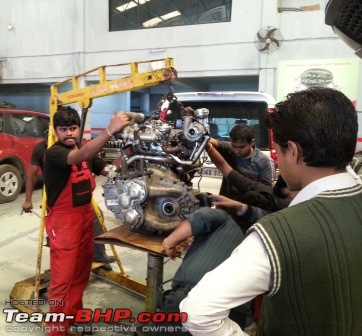

Originally Posted by magikrider View Post
Also the Engine bench is not required I was told. the new engine will be removed from the box and installed directly or something. they have the tools required for it but in this procedure it is not needed. I am not sure about it though.
Hehe, Really? The process of swap would be hoisting the car up in the hydraulic lift to the topmost position, position the engine below on the engine bench, and then lowering the vehicle. Else its would be done by a crane, and a few tyres to support ( pray they ain't yours)
Let me show you .
