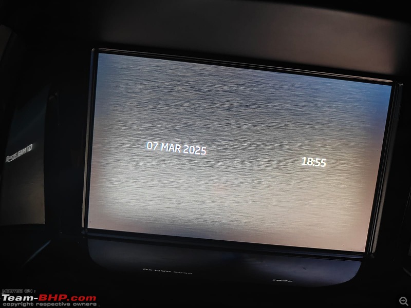

I own a 2018 XUV500 W11-O (AWD) diesel. Last week, I noticed my right headlight bulb wasn't turning on, so I got the front right headlight bulb replaced at a Mahindra service center in Bangalore. While the headlight was fixed, I now notice that the display only shows the date and time on a blurred grey background. All the buttons on the panel do not work (HOME, Info etc) The service center suggested disconnecting and reconnecting the battery to check if that resolves the issue. I plan to try this tomorrow but wanted to know if anyone has encountered a similar problem before and if there is a way to resolve this

Update - I removed the wires from the battery and put it back and things are back to normal.
Isn't this the screen that is shown when the infotainment unit is switched off? Did you try switching it back on by pressing the volume button before disconnecting the battery?

Yes. Once I disconnected on of the wires in the battery and connected it back, when I turned on the engine, the default console/display came back up with all buttons enabled
