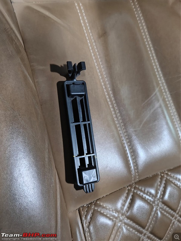

Missing piece - what is it ?
I had my car's interiors cleaned, and after the cleaning, I found this piece left on the seat. Does anyone know where this part might be from? This is XUV500 W11 AWD automatic model
This is the cover for the cabin air filter, located near the clutch pedal.
Refer this video for fixing it.
