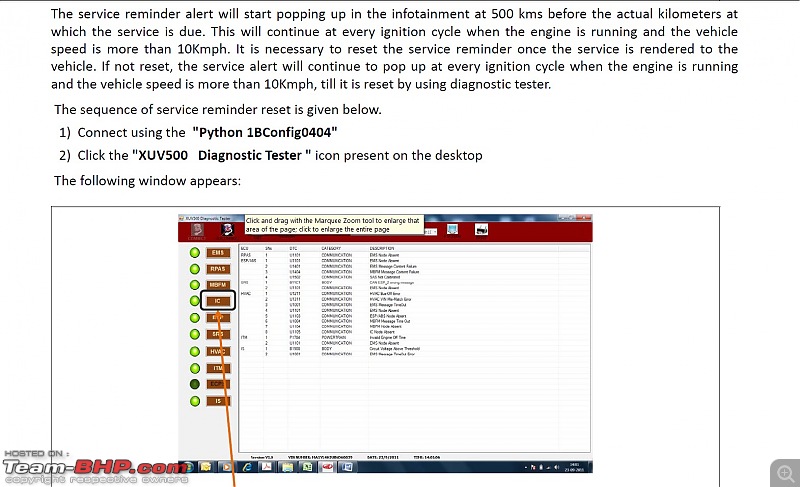

Guys advice needed.
I would be driving soon to Mumbai from Delhi. I got my xuv w6 serviced from outside however they were not able to connect their system to erase service reminder. Now i dont have time to go to service center for this.
So the question is: Does the reminder on the screen keeps on coming while driving or only once whenever you start the engine? If its only once then i can drive down and maybe get it removed once i reach Mumbai or back in Delhi. Anyone??

Originally Posted by nitinralli View Post
Guys advice needed.
Hello Nitin, here are the screen shots from MAN00147-XUV500___Maintenance Manual_Rev1 about DIS Service Interval Reminder Reset ‐ Procedure.
Thanks AutoIndian, i already have this manual from day one, infact after reading through this only i have this concern.
In the manual it says reminder comes when you start the engine and car is above 10 kmph. My concern is that i hope that this warning does not keep repeating itself all the time while i am driving.
Have you ever experienced this situation?
I have a March 2016 manufactured XUV500. I got the first service done @ 5100- 5200 kms. The service reminder was not irritating as far as I can recollect. It would come up once or twice in a day (probably on starting the engine), and then sit as an exclamation mark on the top right hand side of the screen. Infact my second service will fall in the middle of a road trip and am wondering if i can delay it till i return!
ajayclicks is offline   (1) Thanks
Ohh i remember now. You are right, the warning just comes once when you start and after that it goes away with just the mark remaining on the screen. Thanks for reminding me. Now i can just ignore it and drive peacefully to mumbai
