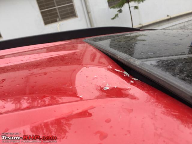

Today I noticed that my XUV rooftop near sunroof has been damaged. Any guesses how this would have happened. This is not a niggle but body damage so if mods feel this is not the right thread, pls merge with correct one.
Also took the vehicle to body shop but they said their first preference is to repair it and if the fitting of sunroof doesn't work then they might think of replacing whole vehicle roof which I understand is a way too long process and fit and finish would be lost.

The vehicle is only six months old such a damage is heart breaking. Has anyone ever faced similar situation. Any guidance will be helpful.
Where is the car parked? Outside or covered parking?
Looking at the damage, the body has caved in which means something has fallen on the car.
Do you recollect any incident?

It's a closed parking. If something would have fallen then the damage would have been near the caves part also like the glass.
Did the car go for service anytime recent?
I can see that paint has chipped off at the location of the dent and just near the start of the glass of sunroof.
