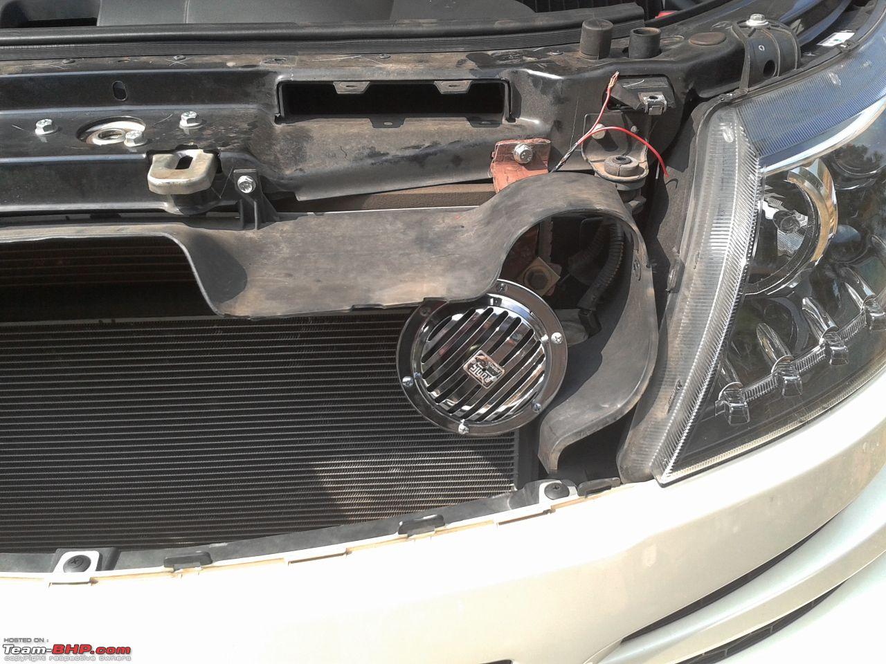

Well my XUV 5oo also reinforces that (6508 Km). I happened to open the front grill of my XUV today to survey the area to place a set of Roots vibrosonic horns, scheduled for tomorrow. I was shocked to see that the horns fitted at the assembly line were not fastened at all (both of them) . The attached video is self explanatory. I am sure they would have experienced Newton law of gravity in a short while from now!!
http://Youtu.be/Gq58A3RlRdo
Removal of the plastic screws (5 of them) was a hard task. It just kept rotating inside the plastic housing. On removing the OE horns I did come across that they were mounted on rubber mountings. This allowed the play. So there is no worry that the horns would fall off. I did get the Roots vibrosonic horns fitted.The original horn mounting plate had to be strengthened so as to bear the weight of the new horns. All inclusive the change over costed Rs 1750.
I have installed Minda horns in my XUV without doing any of the above and they are doing just fine...
raj_5004 is offline   (1) Thanks
I had to do the strengthening of the holders as the Roots vibrosonic are 3 to 4 times heavier than the OE horns

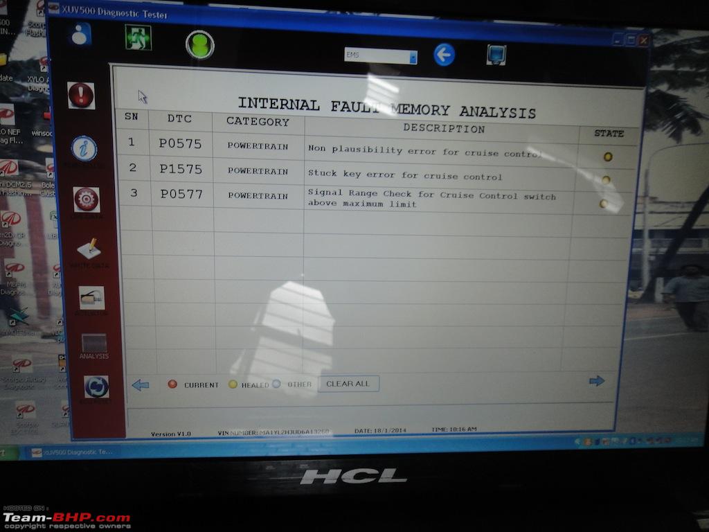

And so gentlemen, fellow XUV owners, if you want to screw-up your Cruise Control, all you have to do is press the + button for a little more than 5 seconds or so, by letting the vehicle accelerate by using CC. It disengages after about 5 seconds of good acceleration and CC doesn't come back up again. Never Ever.
So simple to screw up anything in life. Eh !
You are stuck with these errors for life !
Mudhalaipatti is offline   (4) Thanks
This is one of the errors I saw logged in my vehicle, and, as I have stated in my previous post, it was promptly cleared. Not sure however, if CC is working. It however could also be a safety feature to prevent unwanted engagement of the cruise control in the event of a malfunctioning switch, which could be very dangerous. If the key is pressed for a long time, the system has been programmed to register a faulty key and hence prevent engagement of the cruise control. In your case, was this DTC log cleared? If yes, did it help bringing the cruise control functionality to default, if it didn't, my theory could be wrong..
mdsaif92 is offline   (1) Thanks
Yes it is a safety feature as the system cannot differentiate between a mechanically stuck switch and someone pressing it and holding it. It should reset iteself after ignition off - ignition on after 1 min
spkingsley is offline
Yes it's indeed a safety feature and is the correct practice, to ensure safety. However this should be reset after a minute or so as @spkingsley had mentioned or atleast cleared by turning off and on the ignition. In my case, I even removed the battery terminals and connected back again. The first time, the erros were cleared as well by the SS. The errors still persisted and now my CC wouldn't work atall. I have emailed this issue to the Regional Customer Manager and shall wait for an update from him.
