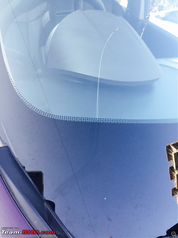

Had parked my XUV in my covered parking slot on a Saturday afternoon. Was shocked to see the windshield cracked when I took out the car Monday morning! The windshield was absolutely fine when I had parked it - there is no sign of any impact as well. The car will complete 2 years in May this year!
Spoke with Anant cars in Bangalore about coverage under warranty , they said they would need to inspect the car. Will be taking it shortly. Mahindra XUV500 niggles & solutions-imageuploadedbyteambhp1424596800.849229.jpg
aajohn is offline   (1) Thanks
Spoke with Anant cars in Bangalore about coverage under warranty , they said they would need to inspect the car. Will be taking it shortly. Attachment 1342360
I have heard from a cousin of mine who works in Mahindra service, that there were some XUVs for whom the glass cracked without a reason. You should probably check with the ASS as if there's no impact, then it has got to do with the windscreen quality.
