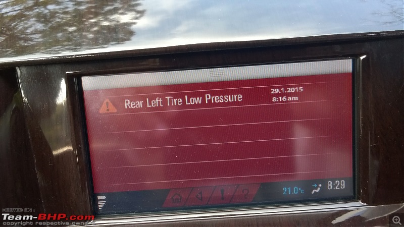

Hi All,
My XUV 500 W8 is about 2 months, 3400 KM old. Been a pleasure so far. I live in Chennai - use the car primarily for city commute - about 20 KM each day.
About 4 days ago, while returning from office, received an alert in the dash, and it said Low Pressure in Rear Left tire.
Went to the nearest petrol bunk, and it was indeed around 18, while other 3 were at 32. Got the RL upped to 32
Next morning, as soon as I left home, the alert came again.
Drove to India Garage service center and they said they would look at it.
Received a call later in the day that it needed a censor correction, and they fixed it. Free!
Picked up the car in the evening, and just as I left their compound, the alert came back again. Returned to the center and showed them. They were certain it is not a puncture. Since I was in a hurry, they pumped air into that tire to bring it back to 32 and asked me to check overnight. (Pressure was 23)
Next morning, when I left home, the alert is back again. (29th Jan). Went back to India Garage again. End of day, they said it was a small leak in the beading between the rim and the tire and that they fixed it. It was a smooth ride back home.
24 hours later, last evening, on my way back home, the alert came back again (as soon as I pulled out from parking lot). Same tire, same alert.
Will be visiting the service center again in the next couple of hours.
Any clues on why this is happening? I see some old posts from 2012 that referred to niggles with tyretronics. Nothing recent.

No - it doesnt! Sorry if my message was misleading! Merely shows there is a low pressure in a certain tyre.
And, the technicians at India Garage finally found a "small" puncture on the inner wall of the rear left tyre and fixed it before lunch.
I have been happier since then!

The pressure is shown if there is tyre pressure low alert. I think you need to press on the particular tyre on the screen and it shows the pressure. Else you will need to check it with the bluesense app.

Bluesense app shows tire pressure reading, but not sure whether its accurate.
I had the same experience like you. Once i had the RL tire low pressure a warning (26psi) and i went to the nearest gas station and topup the air . Again after 1 month , i received the same warning. Visited a tire shop and found it had a puncture. Since xuv has a bigger tire , the tire loses the air very slowly compared to sedan tires ? Again few days back had the same warning and another puncture (19psi) . Two punctures on the same tyre and hence sent to spare .
