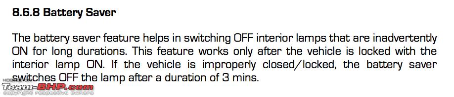

There is this battery saver feature - see the snap from user manual below -
Today I was searching for fallen SD card and had switched on the interior light besides the sunroof switch. I forgot to switch it off. After 3 hours our security called up to inform that light is still on. I was wondering this battery saver should have taken care of it. Read the fine print of user manual - it says "inadvertently". Since i had locked properly, this battery saver did not kick off? Or my interpretation of the feature is not right?
Attachment 1412452
My guess is that it only works for that center light which switches on automatically when you power-off the vehicle. I don't think any other light (mood-light/other reading lights turned on) will get auto-turned off.
Good that your security informed you about the light being on.

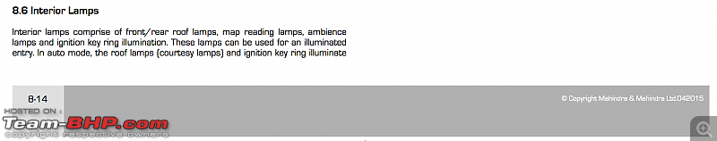

I doubt that. See the fine print below -
The definition of interior lamps include all of these!
I noticed that the lamp on the rear door is covered in this feature but i think none of the lamps on the roof are covered. i noticed this many times and even couple of times these lamps are ON for two or three days.
I guess these are LED lights so they don't drain the battery so easily.
Attachment 1412452
I have 2014 xuv and have locked the car many times with interior lights on. It switches them off automatically. I used to be aware of this only when I open the car next day and finds the light on.
