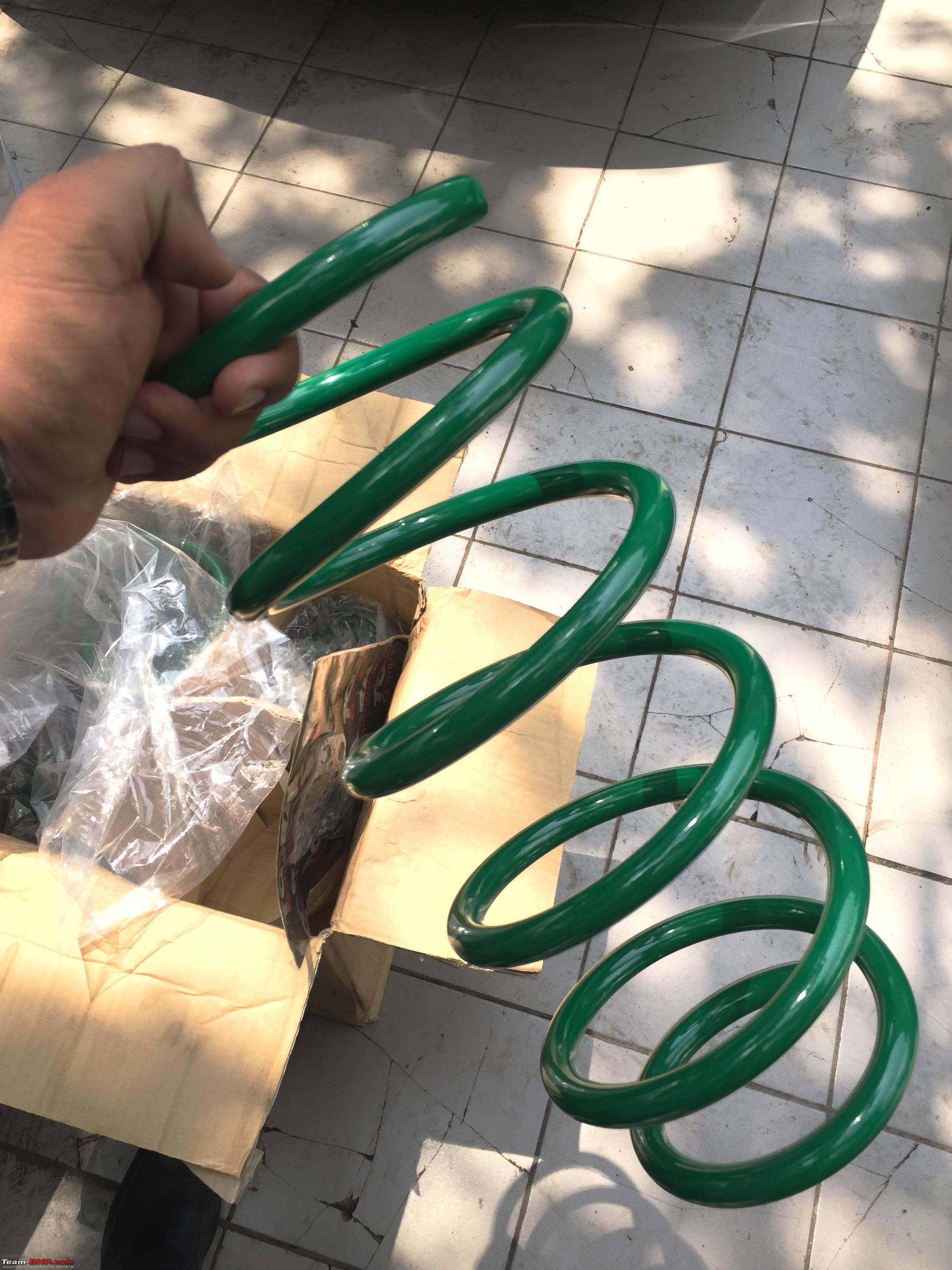

I own a 2012 XUV 500 W8. I have done about 39000 kms till date. I had upgraded the ICE and added an K&N Air filter. I was very unhappy about the ride quality of the XUV and took the first step and upgraded the tyres to Yokohama Advan ST 255/60/R17. These did the trick but the ride was still very stiff. So after a lot of contemplating, I decided to get the Tein springs for the XUV. The springs were ordered from Red Rooster Performance through 4S Auto in Mumbai and installed at 4S auto.
Price and Delivery:
The cost of the springs is Rs. 35,000/- for all four wheels. The installation cost at 4S Auto, Mumbai is Rs. 4,000/-. The parts are delivered to 4S Auto from Red Rooster in 7-10 days after payment of parts (provided stocks last).
Install:
The actual install time is close to 6 hours. The front springs are easier to replace, the rear take a long time to remove and put back after replacement. There were atleast 4 guys working on the car at any time. There is no change in ride height. The most important part that should be kept in mind is to get a thorough wheel alignment after the install. I suggest anyone planning to get these keep a day off for the install.
Experience:
The springs were ordered on September9, 2015 and delivered on September 18, 2015. I promptly showed up at 4S Auto on September 20, 2015. The workmen got to the job almost immediately and were very meticulous in their working. Mr. Chirag and Mr. Ashay were very helpful throughout the whole process and made me feel at ease. All in all it was a very good experience and I would recommend them.
The XUV now feels like a car and not a SUV. The ride has improved drastically and so has the handling. It now feels more planted and more dynamic. These changes are especially noticed on undulating roads where the whole car does not rattle anymore. I had taken it to my wheel alignment guy (Mr. Sanket of Tyre Best, Thane) and he too had the same thing to say.
I have attached herewith a pew pictures of the old and new springs.

At least in the pictures the Tein springs seem to have bigger diameter than the OEM springs or do the new springs have some green coloured plastic coating on them?
Do you know what is the exact difference between the Tein springs and the OEM springs?
Hello AutoIndian,
The following are the visual differences noticed by me in the springs along with the reasons as studied from the tien website:
1. The weight of the Tien Springs are considerably more than that of the original stock ones. This is due to a special alloy used by Tien to give the springs better flexibility as well as robustness
2. The springs themselves are the same size as the stock springs so there in no change in any configuration when installing them
3. The rear springs have a brown dampener that is set out at the lower part of the spring. This dampener is supposed to give the rear a better ride quality and reduce the overall jumpiness of the car
4. The number of coils in the rear spring are more than the original. This also helps when you have a fully loaded car.
A very important point to e noted that i forgot to mention before is that the XUV 500 has alignment options for both front and rear wheels, so when you install the springs, both the front and rear need to be adjusted.
