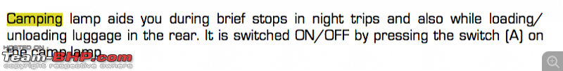

Folks,
This is a query about the New Age Mahindra XUV 500 W10 (Manual AWD). The vehicle has a "Camping Light" on the tailgate. However, when the car is turned off, and the tailgate is raised, this light does not come on when the switch is operated. The bulb seems to be fine (it's a new car with about 100 kms on it). Has anyone else had this problem? Is there some setting that needs to be activated?
Thanks for any help on this.

Old 2nd December 2015, 18:01   #3665
Join Date: May 2013
Posts: 1,936
Thanked: 9,546 Times
re: Mahindra XUV500 niggles & solutions
Congrats for the new XUV!
Nope, there is no setting. Its a manual switch beside the camping light to switch it on or OFF. It does not turn on or off automatically but only with a switch besides it. It can be used regardless of vehicle is powered up or not.
If the bulb is perfect, must be fuse?
Folks,
W10 does not have the so called "one-hour mode". So this is normal behaviour. Not much can be done about it.
Folks,
This might sound a bit silly. I have had similar experience myself. You may try switching it on now and it might work. The camping light in my car has a mind of its own or it seems. It doesn't come on all the time when I switched it on but it does work sometimes.
I have wanted to get it fixed from the beginning but have always forgotten to get it done. It hasn't really bothered me to be honest. Just check again and you might find it working - strange but that's how it has been for me since, I think ever since I can recall. I think I will have it checked during my next visit to the service place. I will add it to the service notes on 'My Mahindra App', and that should remind me to check it. Mine is a May 2013 W6.
