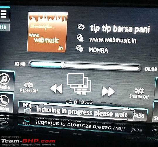

Hello Friends,
I have a 2 day old W11 AWD, which fails to read the USB drive as soon as the infotainment system starts up, further after a delay it reads one audio file and toggles off to FM radio, in a while, failing to detect the USB(4 GB data in a 8 GB drive). Further the track cannot be changed as it reasons " Indexing in progress, please wait" and the wait is never ending. On restarting the system, if fails to read the USB again. I tried minimizing multiple folders to mere 8 big folders, brought a new higher capacity(16 GB) drive, but the problem persists. The same USB drive has been working well in my Kwid though. Has anyone encountered the similar issues?

Stick all the music in a single directory (the drive root, no folders) and see.

Originally Posted by manipal View Post
Hello Friends,
Pretty common problem in earlier generation XUVs. The infotainment system struggles to read large amount of data. It is also a bit finicky in terms of certain USB drives. Please reduce the music to something like 2GB on the old drive and try again. If it is able to read that correctly, gradually add more songs to the same drive. Do let us know how it goes.
If that doesn't work, you might have to show it to the service center folks. But, I am pretty sure that with lesser data, the infotainment would be able to
play music.

@manipal,
I had the same problem in my W11 XUV500 AWD AT. An 8gb usb drive which worked in my other car, was stuck in "Indexing" phase in XUV500. I bought a new usb drive, formatted to EXFAT and it works without any issues. I think i have some 7 to 8 folders with songs occupying like 25% of the drive capacity.
I did try this method, but now the USB fails to be recognized by the system.

Please reduce the music to something like 2GB on the old drive and try again. If its is able to read that correctly, gradually add more songs to the same drive. Do let us know how it goes.
play music.
I did reduce the file size to under 1.5 GB, still not working. I had called up the service centre technician yesterday, he too was unfamiliar with the situation and asked me to get the vehicle. Will update soon
