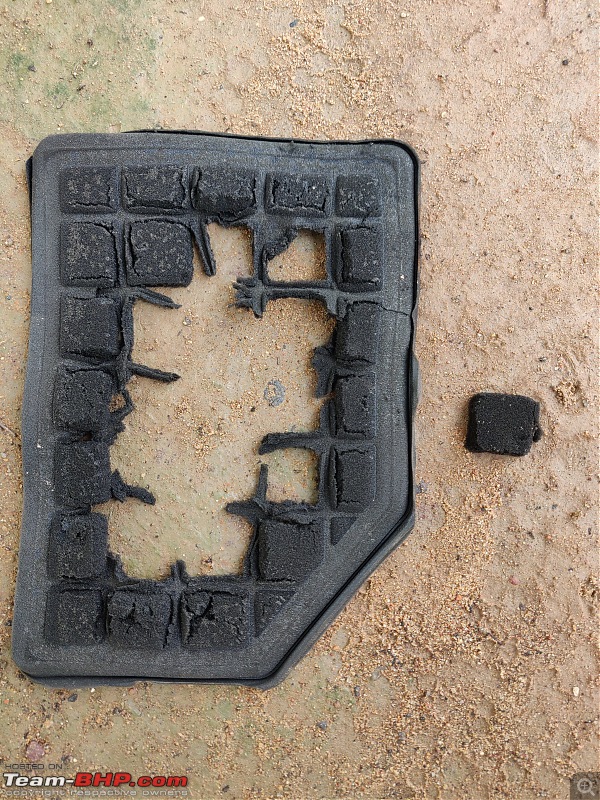

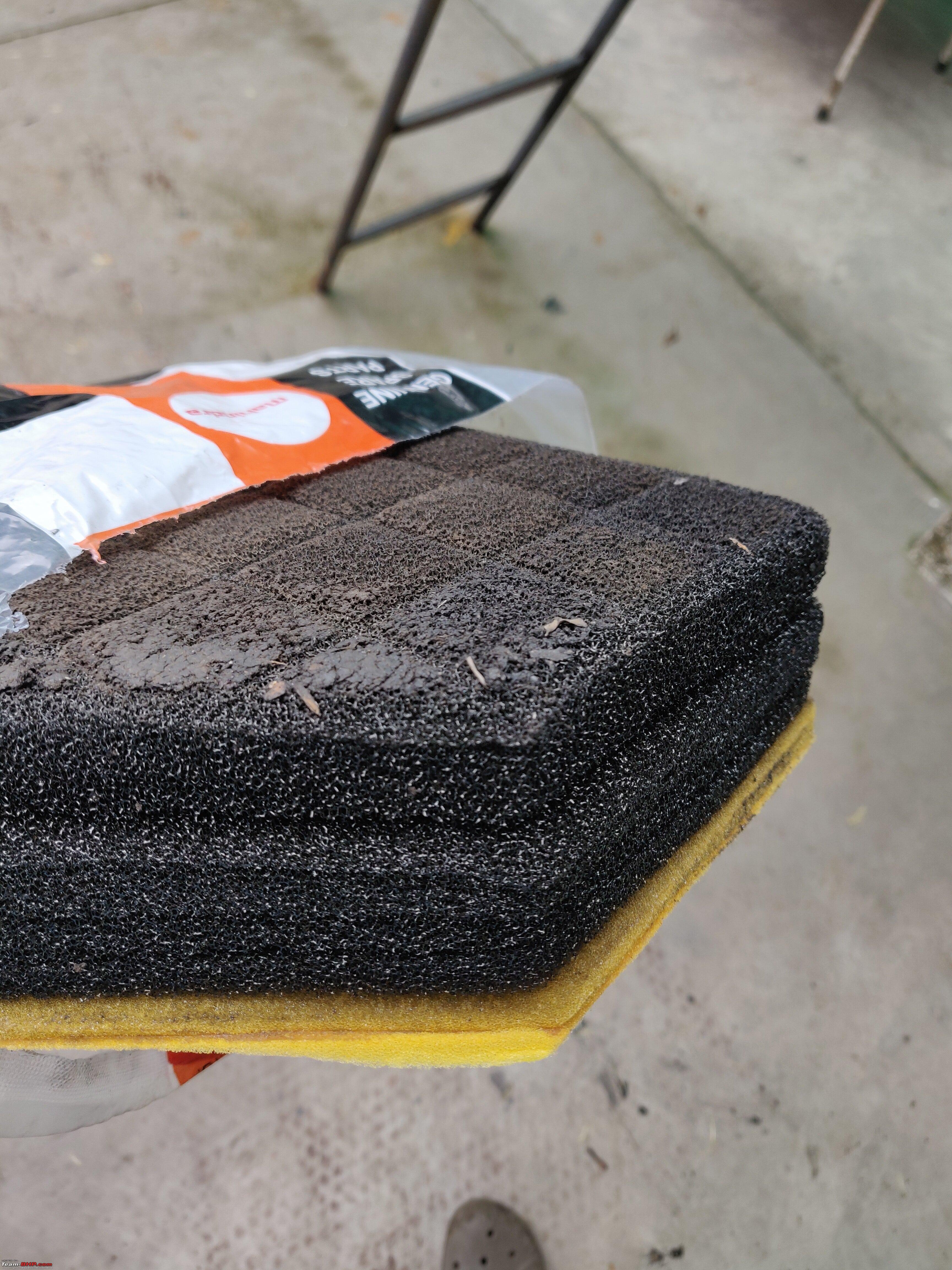

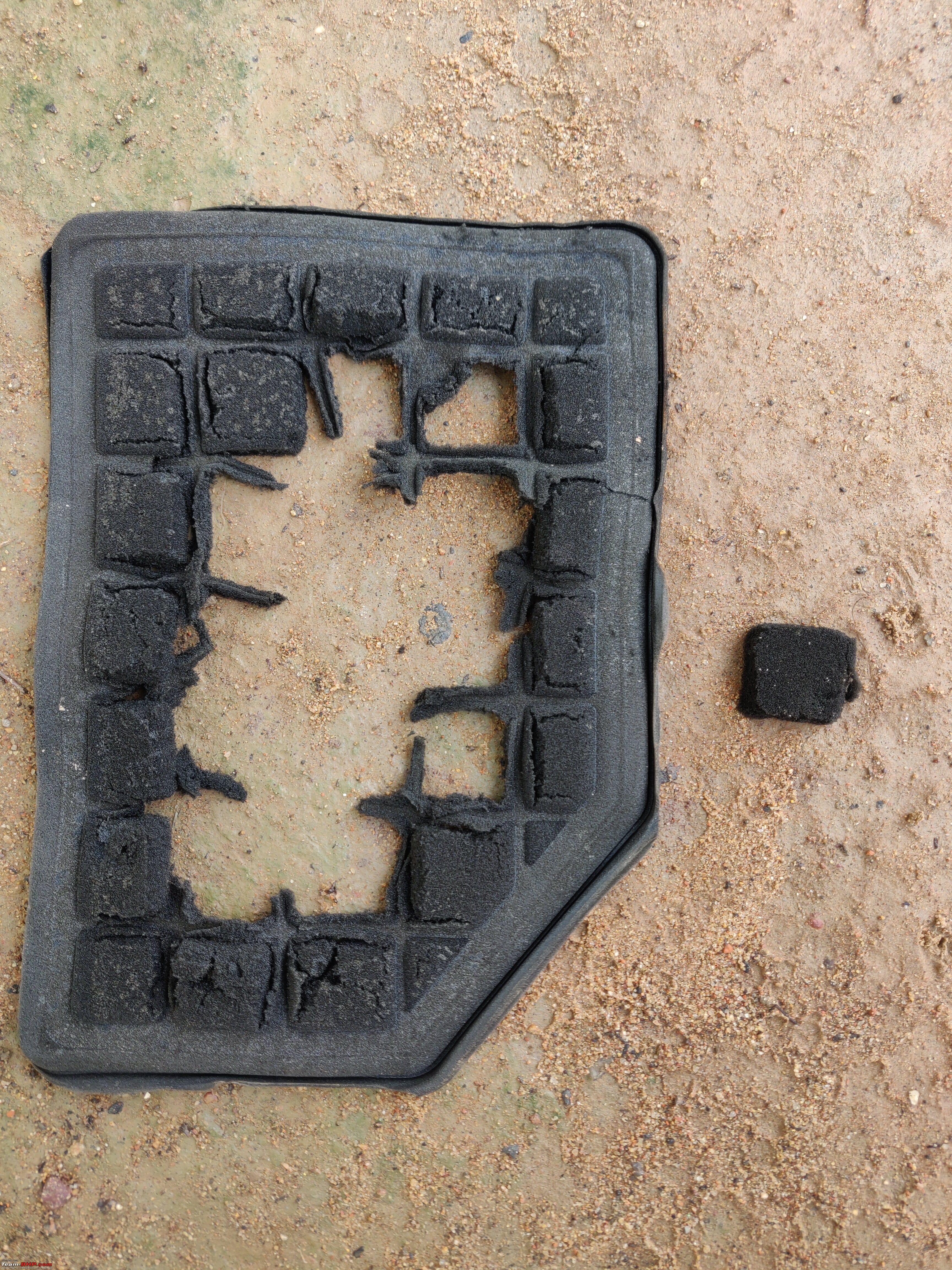

Update on my previous post. The air filter had gone kaput. It is supposed to be replaced at 40k km or 5 yrs whichever is earlier. There is not even a perfunctory inspection mentioned in the service manual before that. The top foam layer had broken into pieces and blocked air entry.
The first photo shows the damaged top layer of the filter. Multiple square piece similar to the one on its right broke off and clogged the inlet.
Second photo shows the clogged inlet after partial cleaning.
Third photo shows the remainder filter.
My doubt is can these small foam particles damage the turbo or the engine. The model is a 2016 xuv w10 awd. I would recommend all xuv owners to get their filter inspected yearly and not wait for the 5 yearly mahindra mandated replacement. The car is back to being a workhorse that it is.

The service manual recommends inspecting and cleaning the air filter and that is done.
You have had rats chew your air filter, looking at the damage caused. Best check whether they also chewed anything else eg the wiring.

The top foam had normal wear and tear, no bite marks. As such it is inside the plastic box. There is a plastic mesh on top, which has cut the top layer into neat little squares, one which is shown in the photo. Atleast 10-12 similar squares were blocking the inlet, which I threw away.
I have attached a screenshot of periodic maintenance, for ready reference. In my case the air filter had never been opened, going as per service manual. The orange tags that break off on first opening were intact.
Do you hear whistling noises from the turbo?
Dirty air filter is possible if it’s an old one that they just gave it a quick clean and replaced it. Or a cut turbo hose.
Bang on hserus. It turned out to be the air filter as pointed out by you.

So the filter just fell apart. Ouch.
Even if they say change the air filter every 40k km, feel free to clean it every 10k km and change it by 20k km, or even change it at the 10k mark depending on whether the area you are in is very dusty for some reason (eg road construction).
And once your car is out of warranty forget the Mahindra filters, buy Purolator or UFI Sofima brand air (and oil and cabin AC) filters.

2. Around 19K including labor.
3. Yes. The above mentioned cost is inclusive of that.
4. Not an issue, depends on the FNG.
5. Looks like a separate issue. Hood opening is a cable driven mechanism, so it should not be related to other issue.
