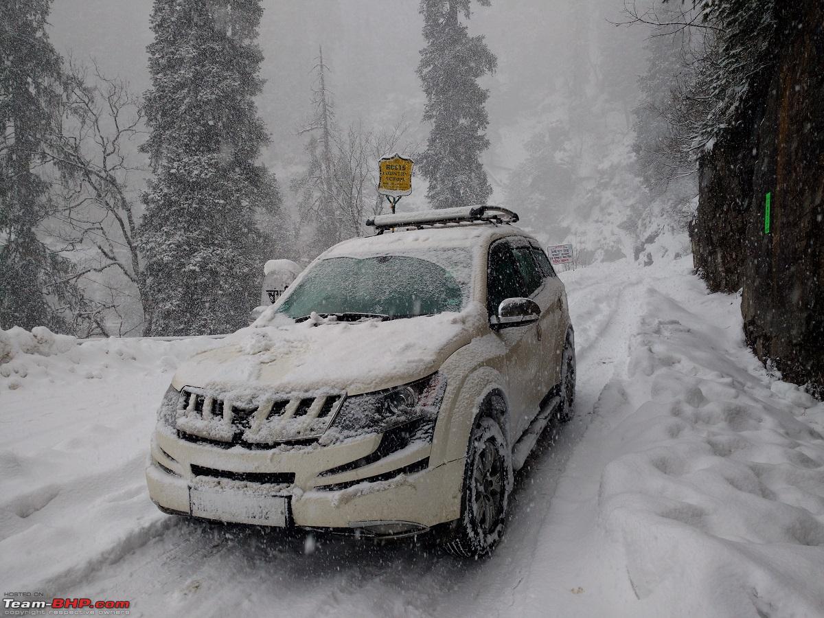

Had a lovely snow drive last weekend (picture attached) at Narkanda and beyond but faced a big issue once I was back in Shimla.
The car refused to start - there was an audible sound from under the bonnet every time I twisted the key but she didnt start (battery wasnt dead). Had to ask a few guys to push it and started it in reverse. The same thing happened the next morning - both times it happened in Shimla.
The car has been running fine since then though. But why did it happened? Any issue with starter motor or something like that?

possibility of starter motor solenoid switch getting stuck due to cold. in that case you will only hear a soft "cluck-cluck" sound when you turn the key. the starter won't turn though.
