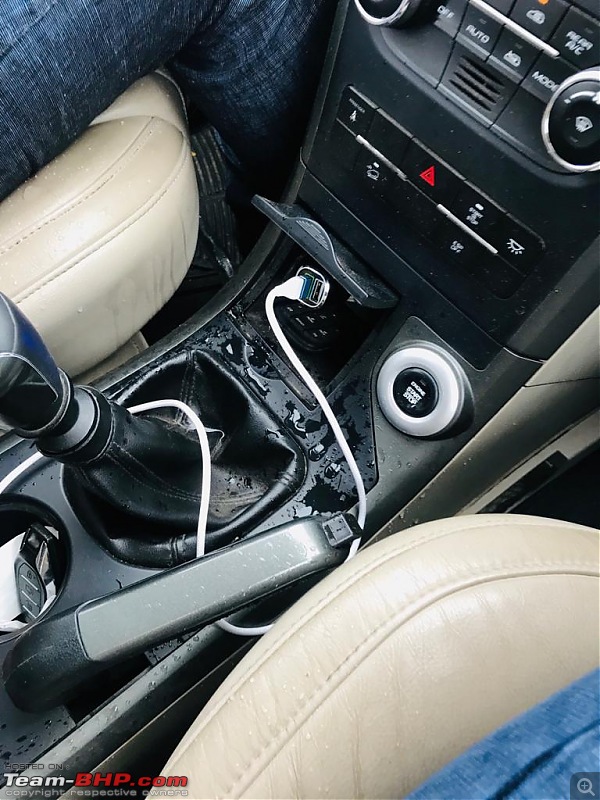

Thanks to my friend, Thej Reddy for sharing these pics.
This is 2015, W10 model. There is leak from sunroof , it was not present before.
This means that the water drainage channels for the sunroof are blocked due to dust or dry leaves. They need to be cleared by blowing pressurized air so that rainwater can drain out.
As mtnrajdeep has already pointed out, the drain channels may have been blocked. Ask the owner if the XUV was being parked in open as small leaves tend to block them sooner. Although sunroofs are practical but have to be maintained well else they surely blow a deep hole in the pockets as rain water seeping in will demand replacement of many components. Your friend is lucky to have been in the vehicle as it was happening and not be surprised with a cab full of water after heavy rains..
Ajmat has a beautiful thread on sunroof maintenance https://www.team-bhp.com/forum/ownin...ance-tips.html (ARTICLE: Sunroofs. India-specific Use and Maintenance Tips)
Thanks for the suggestions. I have informed the same to my friend. He will get it checked at service centre and update.
