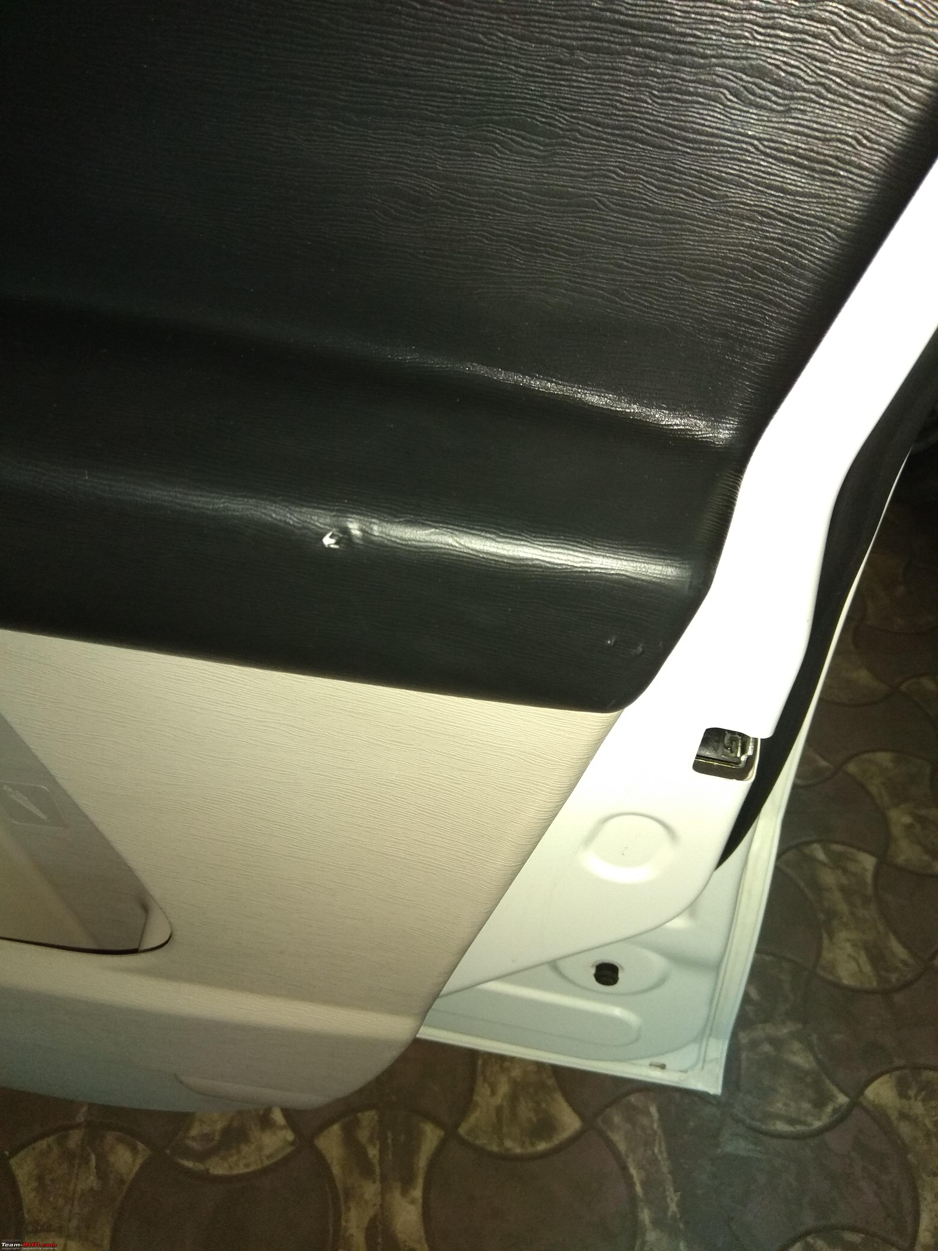

Well, my XUV 500's door trim got damaged during 2nd service. The driver side trim suffered the damage. The dealer pleaded ignorance and has said that he is sure that this wasn't caused during service.
Now, when I asked for the costing to replace the trim, he gave me an amount of 10k for the entire trim replacement of front door. The fabric portion on the top part has got punctured and has a couple of holes in it. I don't want to spend 10k to cover it up. Thought I'd take suggestions from fellow members on what can be done to rectify this damage.
Please help

Originally Posted by Sabareesh View Post
Please help
I don't see much of a damage there, no point changing the door trim for small damage. See if you can get hold of a Live to Drive sticker and put it there. Should look good and will cover up the damage.
