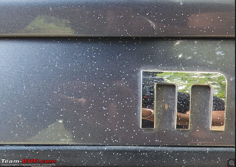

Some metro work guys spilt distemper /paint on my Thar at 5 AM on a weekend morning - I initially thought it was water but in 2 mins it was very clear what it was. I stopped the car and wiped the paint off the glass and bonnet ( it took some hand pressure ) and it came off alright. But The whole of the vehicle is covered with these micro spots now and I have been cleaning bit by bit slowly ( it still seems to go with wet cloth and hand pressure even after 4 days ) but to clean the hard top and the bumpers/fenders ( essentially the non-metal, not glass parts ) is beyond my means.
Any good reference of a detailer that can help remove these spots without dulling the factory gloss of the car? I also have some micro scratches on the bonnet thanks to the irresponsible cleaning guy - need to get those sorted too. I also have some bumper paint job to be done on my Creta - so looking to get all of this done together. Looking for a detailer in and around Whitefield - pls recommend based on your firsthand experience only.
Separately, who can I raise these grievance with? It's atrocious that someone can spill stuff on a car and not be accountable for all the pain and expenses we incur. Atleast 6-7 vehicles were affected that day.

take some diesel and liberally apply to all spots which has paint spots .. let it sit for a while and softly rub away with microfiber. Just re-apply this step if you find spots are still stubborn. Then pressure wash entire diesel away from using snow foam or soap. Rewax the paint after done.

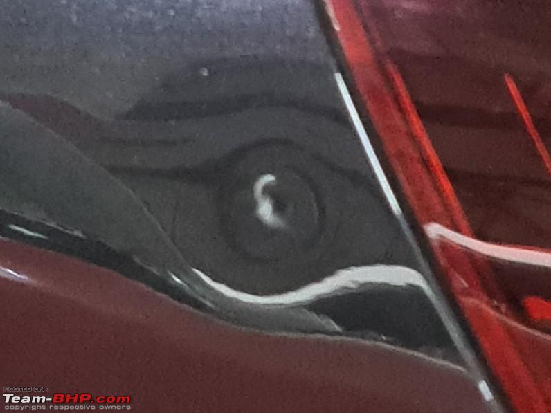

Hello folks!!! Recently my Skoda Octavia mk4 was damaged by some negligent kids while the car was parked. The Dent is small but spoils the look of the otherwise spotless car. Also a tiny spot of paint has chipped off. Can someone suggest how to get it fixed; DIY or any denting expert in Mumbai/Thane? I want to avoid re-painting the entire panel for this small damage.
Hi,
Sorry for the damage on your Octavia, this is actually repairable by the process of Paintless Dent Repair in which the dent is pushed from the inside.
A simple search on YouTube would show you dents worse than this being removed. It’s literal magic how those people make dents undetectable.
The only problem is that, here we do not have any professional with enough experience or knowledge like those in England or the US.(most repair videos are from these two)
About the DIY route, it is best recommended to leave this kind of job to the professionals because if there’s too much force applied it could end up worsening the wound.
I’ve a similar ding on my Polo’s quarter panel, which is repairable but there’s no one here who could do it the proper way. So I’ve made peace with it hoping someday i would be able to get it fixed.
I would suggest you to leave it as is(i know it hurts every-time) and hope PDR industry grows here one day.
Regards
