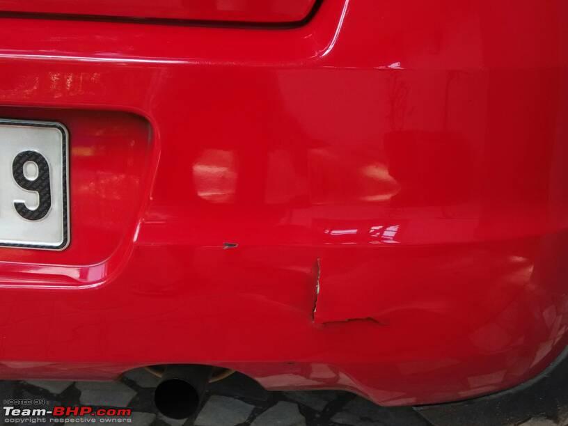

Friends, My Swift red vdi was in need of small denting and painting in bumpers. Last week a biker hit the RH fender and now have a big dent. Plan to give to a a workshop recommended by tbhp friend. The works involve denting and painting both fenders, painting and setting both bumpers(rear bumper have a tear), repainting in RH back door and rear fender due to "bubble" formed due to an earlier painting. The workshop guy quoted 12k.

From the pictures:
it looks like one of the fenders is bent out of shape but no paint is missing. Ask if it really needs the repaint, or with some careful cajoling with a dolly, the dent can be removed.
The other fender definitely needs denting work in addition to filler and top coat.
The tear in the bumper cover can be easily "welded", and the area filled, sanded and top coated - see a bumper repair specialist, for this job to get an idea of the cost.
Has this mechanic provided a breakdown of the 12k - how does it stack up?

Both bumpers(6000), Back fender and Back door repainting (3500), Both fender repair(2500).

I would suggest you to get independent quotations for the jobs from different people. Also check this post... based on personal experience long ago.
