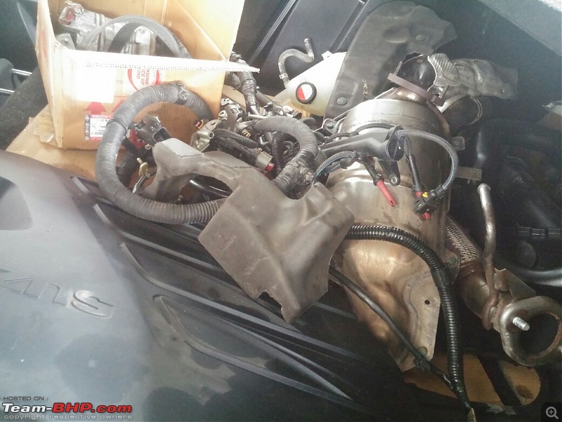

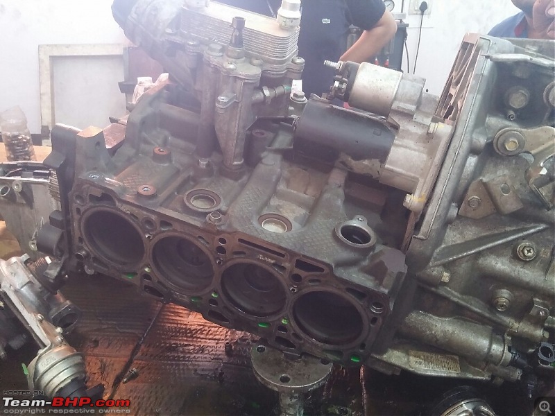

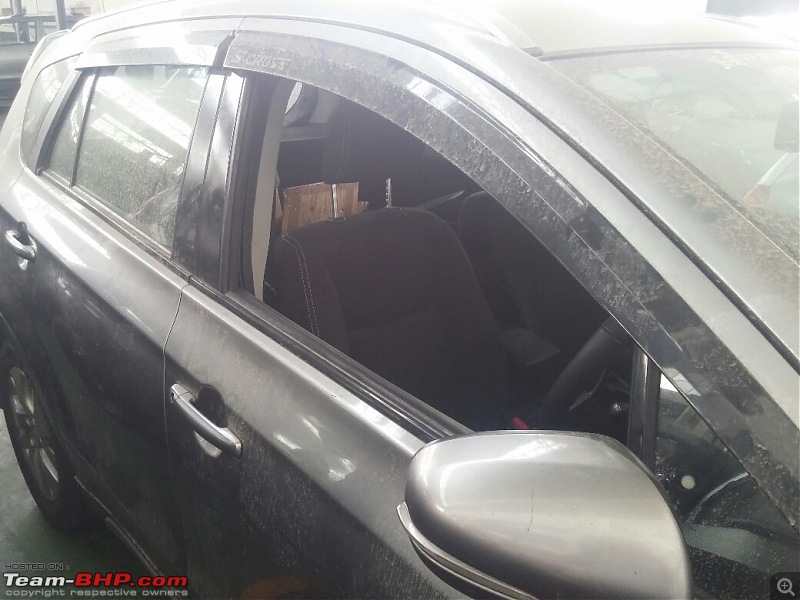

Day 1 (1st May’17) : I was coming back to my home in Greater Noida after dropping my kids at school in the morning . Just before reaching home, the car suddenly dropped power & it shut down. The malfunction light came on . I cranked it again & it started normally & I reached my parking without any issue or power loss. But the malfunction light remained on. I was wondering as what could have happened as last service at MASS Rana Motors, Okhla , New Delhi was done a month ago.
When I opened the bonnet to see the engine bay, I was shocked. It looked like someone has taken the hose of oil & sprayed liberally on the engine bay. Every part of the bay was covered in oil, battery tray was in half a cm deep pool of oil The hood was covered in oil from inside .
But I never knew that this is the start of a long nightmare. It will rip apart the notion & faith of me & my friends in façade called Maruti which proudly states that it is Numero Uno in CSI since last 17 years .

To top it up my blood is boiling looking at the pic where they have dumped car parts on the back seat. How irresponsible can they be?

Fuel adulteration killed the engine.. Seriously?? How did they conclude about fuel adulteration? Any testing of the fuel quality was done?
This has happened after you got the service done. I am sure the service centre guys filled in more oil or did not drain the oil fully. Also, I am shocked to see this kind of treatment from Maruti Suzuki!!

The thing that sticks out here clearly, is the spray of oil inside the bonnet and all over the engine bay, any idea as to what kind of oil it was? Colour? I'm yet to clearly understand how adulterated diesel would result in this, yes many times engines have seized due to adulteration but never in this fashion. Also shocking is how they have kept the car inside the garage, it looks horrible, engine parts strewn every direction and kept inside the hatch of the car with the rear seats folded (grease, oil stains and muck transfer guaranteed).

Shocked after going through your ordeal. To me, it is definitely not related to fuel adulteration. It is most probably because of some error in the last service. I have seen NCR's MASSes, and they are the least competent of all MASSes in India.
