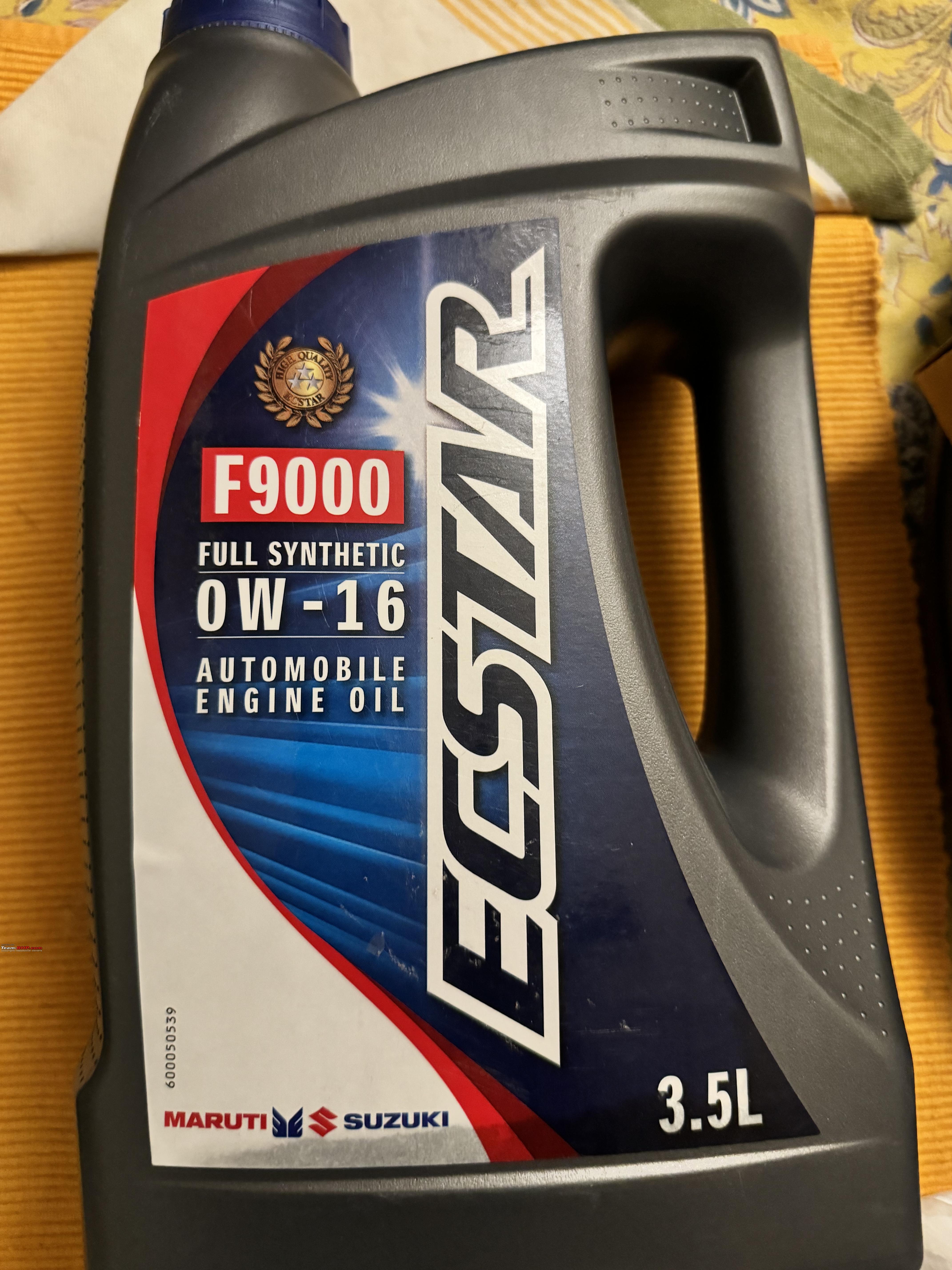

Re: Approved Engine Oils by Maruti Suzuki
This is the oil which Maruti recommends for Jimny, Ignis etc.
EcStar. 0W-16. Fully Synthetic. It is not expensive. And its is clearly a good oil. I see that they have been endorsing it for years across vehicle types; a fact which is visible in the Suzuki Headquarters and Museum in Hamamatsu, Japan, where I saw it in August this year.
I think it makes sense to stick with it since Suzuki themselves recommend it and we should pay heed to their own engineering and research. If the vehicle is used a lot then just change the oil more frequently.
Im going to use this oil in the next oil change. The Jimnt takes 3.6 litres including the oil filter. The EcStar can contains 3.5 litres which is what Ive bought and kept. Normally at service they will take the requisite quantity from their drum. So in my case 100ml of oil will come from their drum.
Or else I may choose to use 3.2 litres from the can and add a 300ml can of Liquimoly Ceratec just to keep things nice and smooth in our high stress stop start traffic scenarios.
This time when I got my Baleno serviced, I was right there at the bay, the whole time and saw that they got these 4 pipes (akin to the petrol dispensing pipes) that are connected to some tanks or drums that you can't see. The mechanic pressed a few buttons, I think indicating the volume of oil he wanted it to dispense. He then just pulls the pipe, inserts it in the engine oil bay and then automatically the oil is dispensed. I didn't expect this at Maruti to be honest. I still prefer to look at the oil being pumped it through the oil can, the old fashioned way.
However for synthetics I think, they will probably use the cans as they won't have it dispensing through the pipes.
At Nexa showroom I asked them for fully synthetic options, they said they don't provide any and all they have is mineral oil in 0w-16 grade which they pump from a barrel. Will check again with their GM this time.
