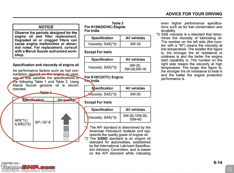

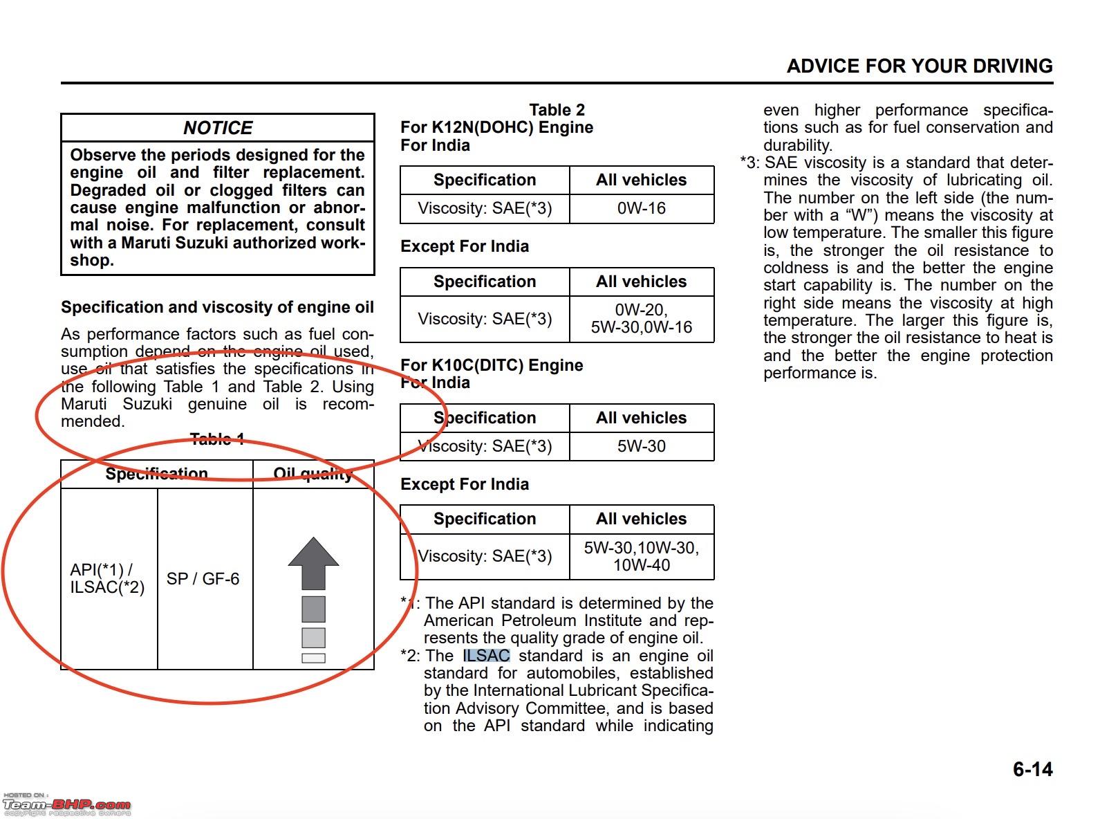

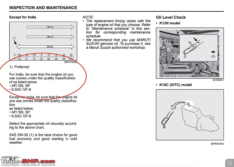

Hi everyone,
Today, I took my Fronx Turbo 1.0 AT for its 1st service at 1000 km. I wanted to get the oil changed as a precaution.
As expected, the service advisor was not aware that the turbo model requires a different grade of oil (5W30) compared to the non-turbo model (0W16). They didn't have it at the moment, claimed to have it until 2 weeks back, and weren't very eager to arrange it soon enough or in smaller-than-bulk quantities.
What has confused me even more are the following 3 things:
1. The Quality mentioned in the manual is API SP, SN and ILSAC GF-6. In one page, only API SP or ILSAC GF-6 is specified, whereas other pages give option of API SN as well. Does it mean that older quality type API SN can be used? I have understood as much that API SP is the latest, API SP with Resource Conservation matches ILSAC GF-6, and API SN/SN+ is older than both of these. API SP and ILSAC GF-6 are specifically designed for new turbo models around the world.
2. I saw barrels of Castrol Magnatec Professional 5W30 in a corner of the service centre. In so far as I have checked, Castrol has one very specific grade of Magnatec that comes in API SP quality, whereas rest is maxed out at API SN. I called up another workshop, and they didn't have Castrol, but rather Idemitsu, for which I could not find any API SP quality 5w30 grade oil anywhere. Both have API SN though. I have checked at few MGP stores and couldn't find them there.
3. Manual has not mentioned any brands. I'd like to have a backup since they don't seem to be stocking it everywhere. Should I be looking for Maruti branded oils, or can I simply put the required grade and quality of oil from any brand - and whether this will affect my warrant? Note that the Service Centre was more than happy to write "oil provided by customer" on the bill. I would be very happy to put the best oil, cost no bar, but I definitely don't want to blow the warranty.
Page where manual clearly says API SP or ILSAC GF-6. Also that MS Genuine Oil is recommended.

Page where both API SP or API SN are specified.

Page where both API SP or API SN are specified. No brands are mentioned.

Yes, API SN of any brand can be used.
zeng is offline   (1) Thanks

Engine oils are usually changed for every 10,000 kms or every 1 year, which ever comes first. All the metal dust and particles will be stored in the engine oil filter and the oil filter is also changed when the engine oil is changed.
And for 5W30 viscosity of the engine oil, I would recommend to go for Shell HX5. Maruti Suzuki has a Shell MGO Premium Multigrade Oil (Part Number: SHELL5W30MGO3). But this is an API SL grade oil which means there could be more percentage of additives which could poison the catalytic converter or may not meet the BS6.2 emission standard. Also note that this is a pure mineral oil and not semi-synthetic or fully synthetic.

Thanks mate! I wanted to get the engine oil and oil filter changed as a precaution after the run-in. I know that it is not needed as per manual, but changing oils sooner than recommended is a practice that I have followed for my other vehicles. Fronx's manual mentions driving precautions similar to run-in period for 1st 1000 km, and hence I felt that this precautionary oil change would be good for long term ownership.
I have seen that Shell oil, thanks for helping with it!
I found out that Maruti has only one synthetic based engine oil of 5W30 grade - Castrol Magnatec Professional 99999MS5W30-CAS - and is API SN rated. This is the only one to be found in all of their workshops and official brochures. They don't have an authorised fully synthetic 5W30 oil, even from Castrol, which sells other API SP rated fully synthetic oils under the same Magnatec brand.
