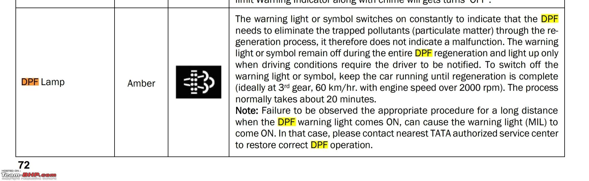

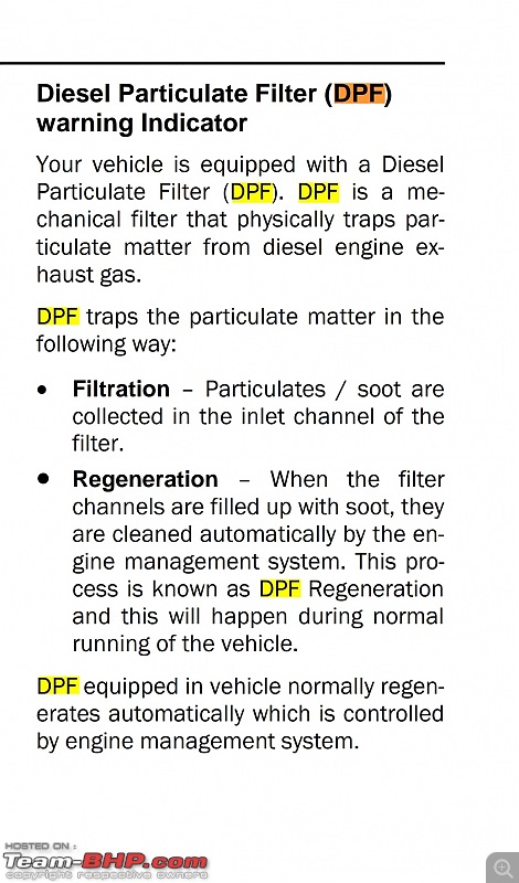

Re: Diesel DPF clogging due to short city commutes
Attaching the relevant section from Harrier BS6 owners manual for reference -
Diesel DPF clogging due to short city commutes-screenshot_20200822103316_drive.jpg
Diesel DPF clogging due to short city commutes-screenshot_20200822103408_drive.jpg
Diesel DPF clogging due to short city commutes-screenshot_20200822103448_drive.jpg
TATA Motors recommends about 20 mins of running above 2000rpm to regenerate the DPF if the warning lamp comes on.
Also, do note - this isn't a major malfunction indicator, so nothing to panic - unlike some of the other warning lamps. Modern diesel owners will be seeing this one quite a few times in their ownership. That said - can't be ignored either as the car can't be used for long without regeneration.
