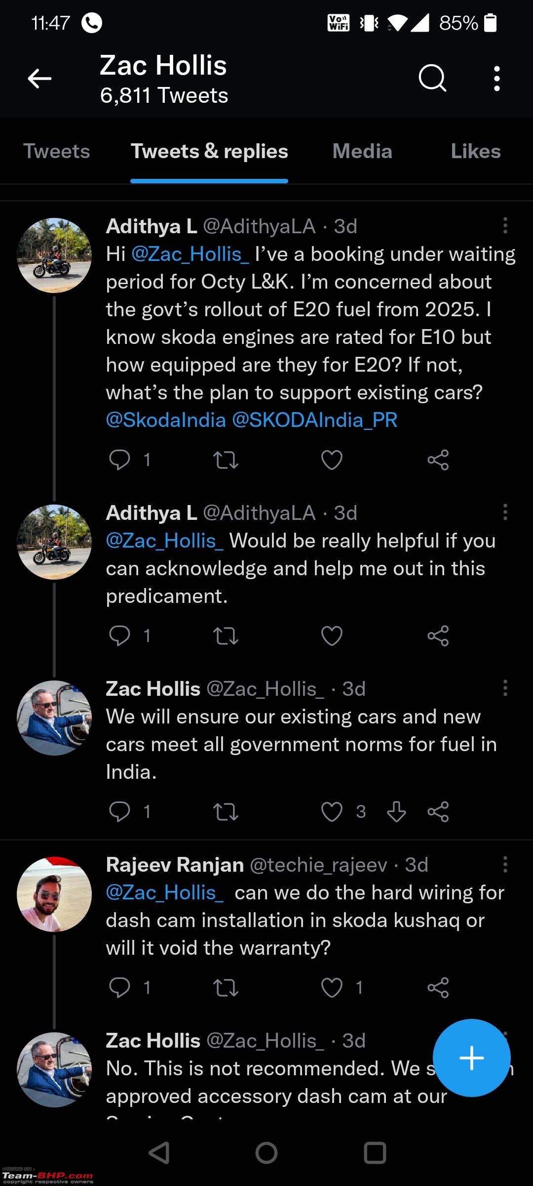

Zac Hollis has replied to a query on twitter stating that all Skoda cars, both existing and future, will be made to comply with the new fuel norms.
