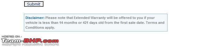

My 2.2 will complete 2 years on March 15th 2010. I thought I can buy extended warranty prior to completing 2years; guess I was wrong !
Can someone confirm this please?
Duh! I was also under the same impression. I thought one can go for extended warranty before the primary warranty runs out!
JK, would suggest that you put on a very innocent face and head down to the TASS and have a check.

Thats what it says, because the insurance company also takes into account the interest they have accumulated from the initial period. They are smarter.

Does this mean that they changed the rules recently?

I offer the same suggestion. Walk to nearest TASC, and say you were ignorant. For the old 3.0 my uncle had, we got extended warranty 2 days before the original warranty expired!
