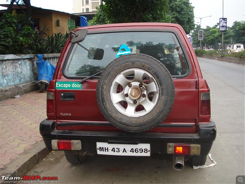

Lo and Behold! The pictures of the car (as is, where is)

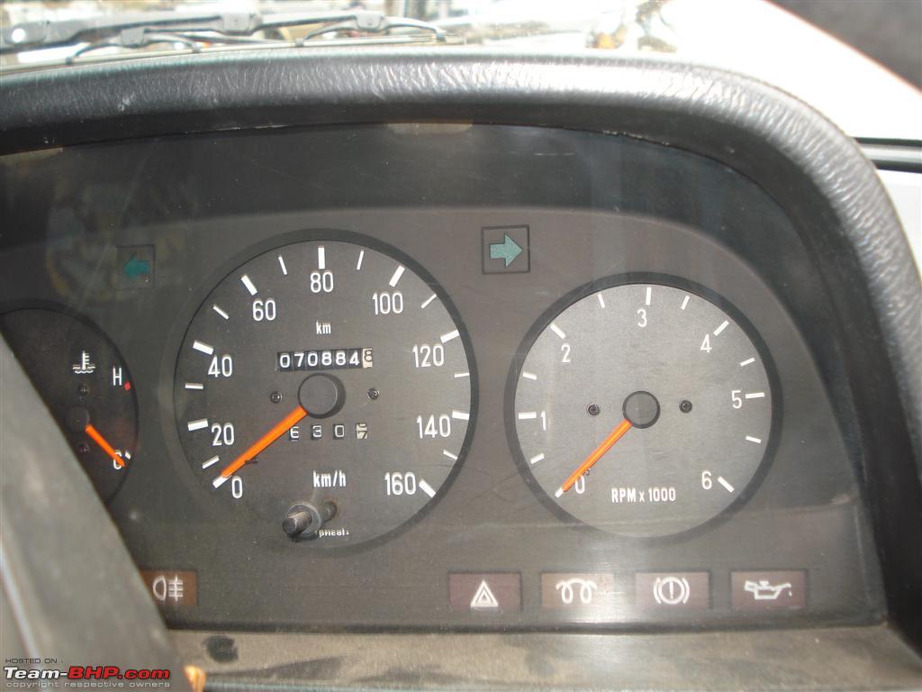

nice.. but why is the steering wheel upside down??
also, doesn't the Turbo come with a blue coloured instrument panel?

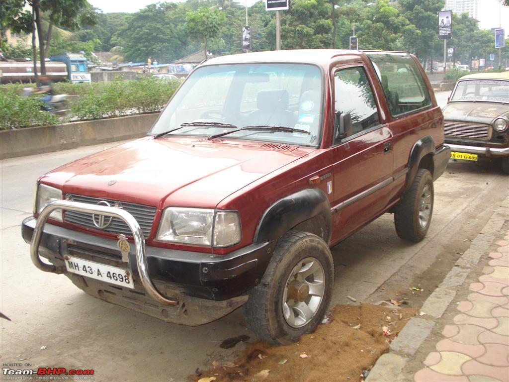

The car looks like a finely maintained one, atleast in the pictures. The tyres really needs tobe changed as they are not coping up with the car.

@Bullitt, congrats. Looks to be in fair condition, good enough to get working on it and get it to your liking. Engine layout looks to be the same as in the TCIC Sumo..
What FIP is it running ? Any plans of getting a diff one ?
What's the plans for the A/c ? Are you going to get a diff compressor along with the blower ?
underground1419 : .. but why is the steering wheel upside down??
If you notice the front wheels pics in the 2nd & 4th pics, you can see the wheels have been turned a little. That's the reason for the up-side down steering wheel.

bullit i envy you the car is in as good condition as any that can be found in that price range in the market today .the alloys and tyres are a quick fix kurla cst job(the local scrap market of mumbai) for the daily ride and safety change the tyres asap you will get a good buy back in vashi new mumbai .if the FIP is LUCAS will give better mileage but more expensive to service if THAT GOES KAPUT just shift over to mico.the instrument cluster was changed only in the 2000 model sierra all earlier models had the old one .for better cooling if required can change the condenser fan to a higher rpm rating.as you will come to know over a period of time as far as the sierra is concerned the thumb rule is IF IT AOINT BROKE DONT TOUCH IT

Thanks for the approval guys, it endorses my belief that I have bought a good car.

Condor is right about the upside down steering wheel. Thats how it got parked after the TD, and the steering locked when the key was removed, so we didn't bother straightening it. I'm not sure about the instrument panel, I guess its like what the good doctor says. ^^
@ mercedised:
If you see in the fourth picture (front 3 quarters view from drivers side) where the wheel has been turned outwards a little, the taper in the tread is very obvious. The tyres are near bald on the inside, and good as new on the outside. The mechanic said that they can be used for no more than 6 months, provided we flip the tyres on the rims (to bring the inner side out). I will probably change them anyway once the car has been done up properly.

As for the tyres and rims, I need full details about the stock rims of the car, specially the offset. My guess is that the existing alloys have incorrect offset, causing the tyres to stick out a bit too much. I will probably change the alloys to stock Safari rims if I find them unsuitable. I believe later Turbos used to come with the same rims as the older TCIC Safari, and those look quite good too. Any idea what a used set of Safari rims would cost?

THE ac upgrade is to use a superking blower with a 508 compressor no amount of filming is going to cool the car the safari standard rims and tyres will fit so the issue of the offset is solved besides in the right hands the measly 68 bhp in the right hands can and do wonders for the sierra .as mentioned earlier the safari rims in 16 inch with tyres will cost 25000
