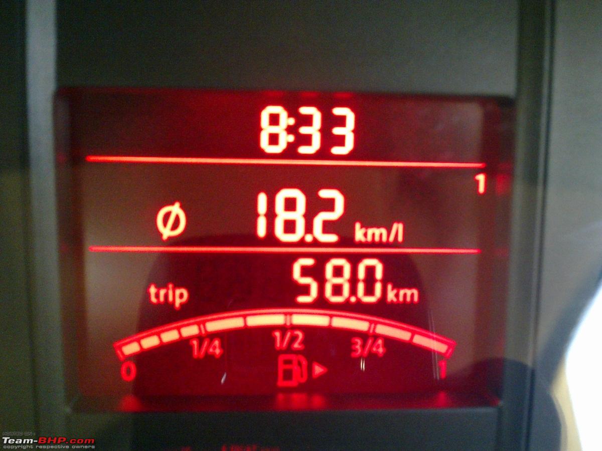

Early morning drive in addition of colder air results in superb mileage. Have a look at distance to empty(DTE) which is more than 850+ Kms. 1.6 TDi beast if kept under steady 90 Kmph gives very good mileage and DTE at 870+ Kms means you can undertake any long journey without much fuss.
