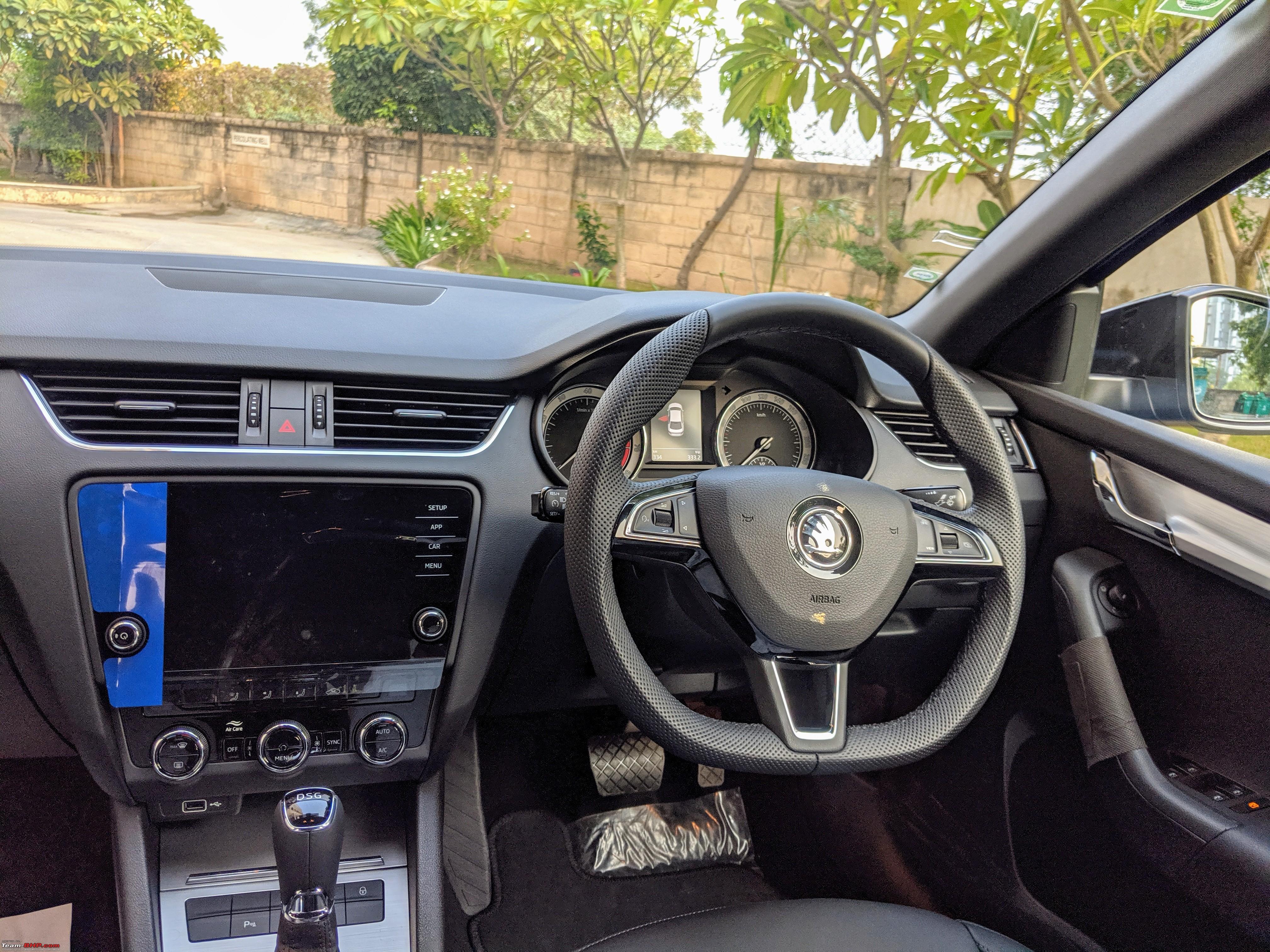

Old 12th November 2019, 14:02   #3861
Join Date: May 2019
Location: Ahmedabad
Posts: 58
Thanked: 55 Times
re: Review: Skoda Octavia (3rd-gen)
Originally Posted by Timothy View Post
Hi Sumesh,
Do post some pics of the interior also.
Sorry for the delay. I am posting some of the interior pics of the Onyx.
Regards
Sumesh
Review: Skoda Octavia (3rd-gen)-img_20191110_163718.jpg
Review: Skoda Octavia (3rd-gen)-img_20191110_163654.jpg
Review: Skoda Octavia (3rd-gen)-img_20191110_163621.jpg
Last edited by aah78 : 13th November 2019 at 22:47. Reason: Pictures inserted in-line.
Sumesh_Jazz is offline   (7) Thanks
