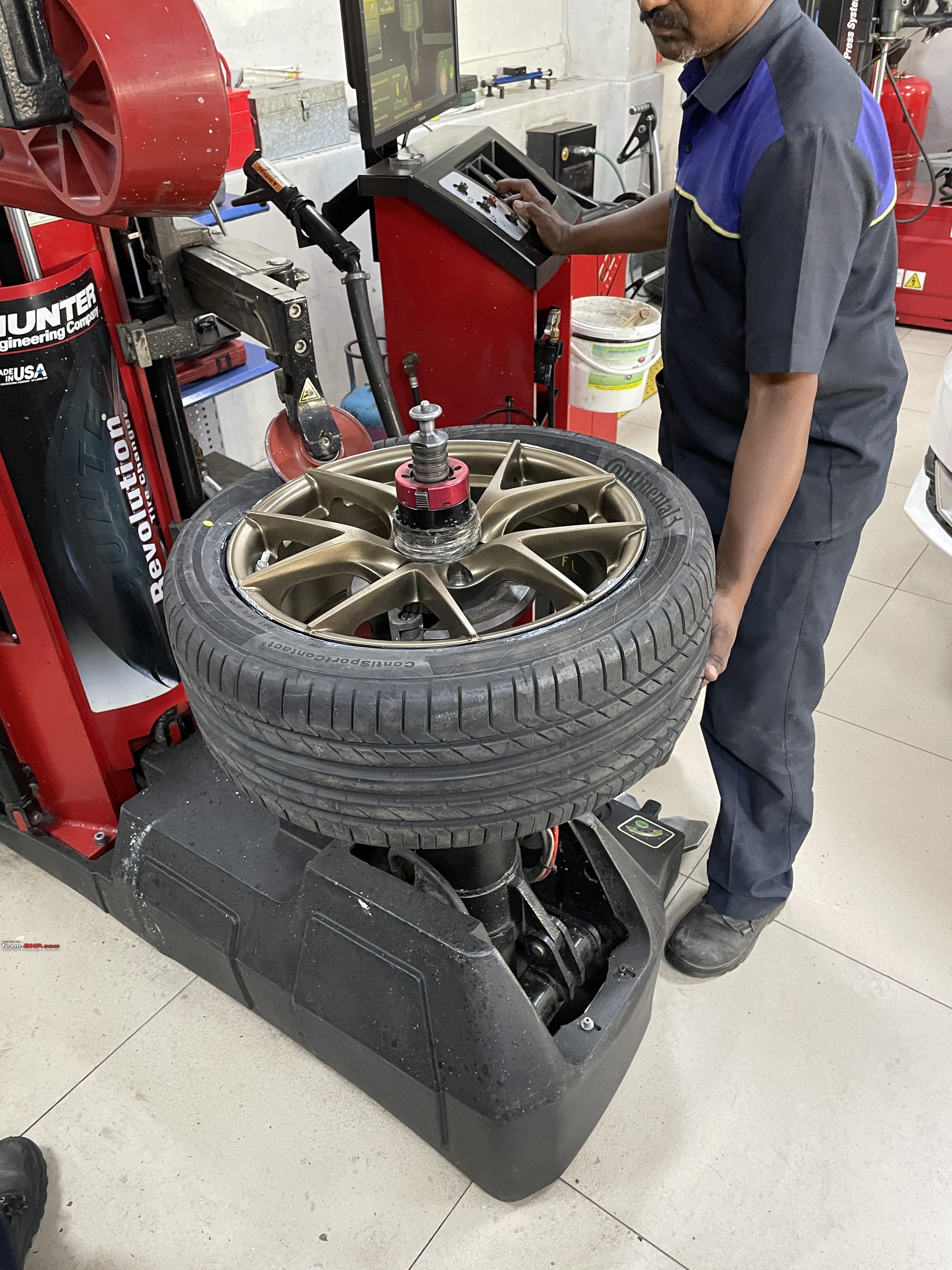

Hello members,
Our Octavia MT 2.0 TDI turned 9 years and has aged very well. Out of the 4 cars in our garage this is our most favourite one. This car was primarily used by my dad and now since he is ageing he's finding automatic transmission more comfortable and hence this would be my primarily used car. In these 9 years we have never faced any issues other than dead batteries and recently fuel flap was stuck. Also our running is very low as it has done 46000 in all these years.Review: Skoda Octavia (3rd-gen)-img7829.jpg
So thought of spicing it up a bit as its not the primary family car now. So started off with alloys and ended up with Lenso Jager Dyna in 17''. And the rubber was ContiSportContact5 as Michelin PS4's were not of recent stocks.Review: Skoda Octavia (3rd-gen)-img7831.jpgReview: Skoda Octavia (3rd-gen)-img7832.jpgReview: Skoda Octavia (3rd-gen)-img7833.jpg
P.S. The Benz E-class behind also opted for same design although in different shade.
Now next plan is to upgrade the suspension to Bilstein's. Have kept remap in mind as well but pondering over it as i'm content with the stock power for most of my usage.
THE FINAL LOOK.
