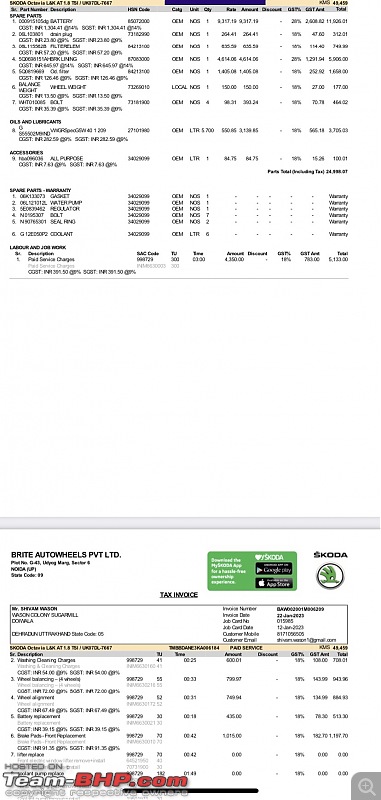

Originally Posted by satish_appasani View Post
Got the battery replaced with OEM Varta battery for 12K.
Can you share your bill if it is handy? I am wondering why i was overcharged by 3000 for changing the same battery.
Attachment 2429936
This is from my recent service, in January 23, at Brite Skoda Noida. I was charged Rs. 11926/- for the battery and Rs. 513/- as labour for the replacement. I frowned upon the skoda team for charging labour separately when they are already charging me for the complete service but I guess I have been charged the lowest of the lot here.
Attachment 2429936
Mine in November'22 (Ring Road Skoda - Gurgaon) had the exact same charges. I did a preventive replacement of a perfectly working battery at 3.2 years. Since they don't pay anything for the old battery, I asked them to return it to me. When I tried to sell it, it was a full dead battery, reasons are anyone's guess.

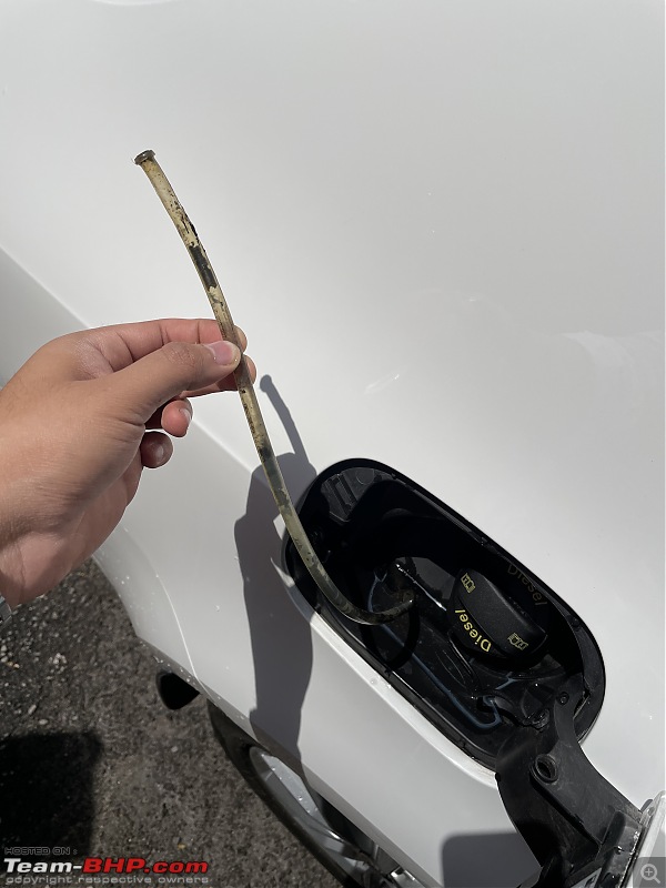

I’ve found this issue in my car that whenever it’s washed, there will be water stuck below the fuel cap. After trying to clean I found this pipe and it’s filled with dust and grease. This is a 2014 car. Is there a way to get this cleaned or is it to be replaced?Review: Skoda Octavia (3rd-gen)-835c9055425b41a0a2968288a27a54c1.jpeg
I poke the dirt out with a twig if I see water accumulated in there. Another thing that works is pressurised water being sprayed through the pipe via the drain hole in the fuel filler area. However, all of these are temporary and dirt will continue to accumulate there.
A funny side note: My petrol pump attendant has also started cleaning the drain after seeing me do it so many times. We both laugh over it every time he finds water under the filler flap.
Main purpose of this pipe is to remove any fuel spillage.
Dusty air and daily car wash will certainly over time cause the muck to choke it up.
Try cleaning the opening and that should get it sorted.
