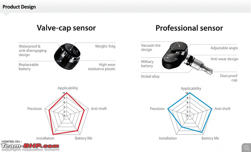

After much deliberation from my side and due to the inconsistency of petrol pumps to deliver optimal tire air pressure, I decided to go in for a TPMS. Now, there are hundreds of brands available and many different types too.
1. Cigarette lighter charger type with a small display
2. OE Fit Display (where the indicator fits into one of the blank switch slots: Only Toyota and Honda models available)
3. Solar and Electric powered dash-mount display
4. Display-less TPMS (only audible alarms, and visual LED indication)
5. Display output to a DVD player or an Android head unit
6. Display output to an iPhone or Android device via Bluetooth.
Types of Sensors:
1. External with replaceable battery (easy to install, easy to have stolen too)
2. Internal with non-replaceable (but long-life) batteries (need to get it installed at the tire station, but then again, almost impossible to steal)
After mulling over these TPMS units for months, (maybe more than a year) I decided to pull the plug. Now I didn't really want to skimp on the unit, nor the sensors, but I also didn't want to add to the clutter of my dashboard. I don't like auxiliary things crowding the dash or being stuck to it with double-sticking tape (this comes off in Indian heat, even the 3M kind) nor did I want my cigarette lighter slot (I use it attach my Samsung Travel Charger) to be occupied, and I sure as hell didnt want to add an adaptor that accommodates two devices on one slot, hence pulling more power than needed. Also, my head unit comes with auxiliary video support (in fact, even the Brio has a Sony XAV-712BT which has Auxiliary video, as well as a dedicated button to switch to the same) and I thought, the coolest and best solution for me would be the one that comes with an ECU that outputs video onto my touchscreen infotainment unit directly. I didn't want to go in for external sensors for sure, because they are basically like valve caps and both my brand new cars are missing a valve cap each, already. (Pathetic!)
So after this long rant, I present to you, the Steelmate TP-05 In-Dash DVD TPMS with Wireless Internal Sensor Tire Pressure Monitoring System
http://www.aliexpress.com/item/Steel...030804359.html
With this, I will be able to monitor car tire pressure in real time, from the cockpit itself. The pressure values will be displayed on my head unit and I am very happy that this is the case, and I don't need to add any more stuff to the already busy dashboard.
I've chosen the best brand possible, and I don't think I will need to bother much about this purchase after installing it, and it should outlast the life of the car, considering the premium cost I am paying for it.
