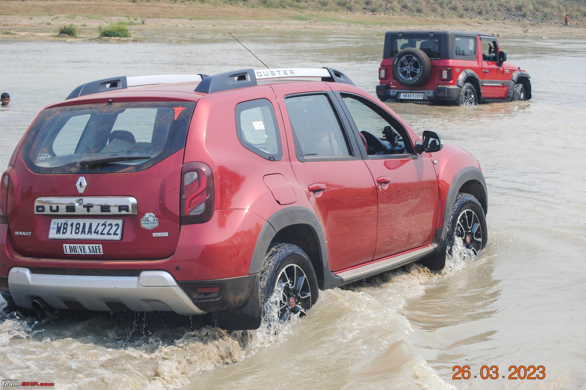

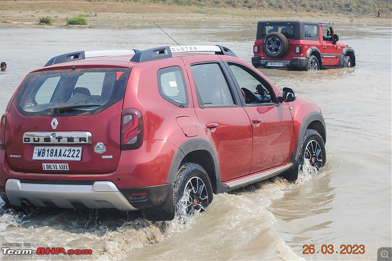

Attended an OTR with Kolkata Offroaders in the meantime. This event had a lots of driving through water and slush, while the outside temperature was more than 40 degree C.
The car performed beyond my expectations, specially on the river crossings. Duster as usual was good on slush. The Ac was turned off during the water crossings, on rest of the time the AC kept the cabin chilled in that heat!
Post OTR got a thorough wash of the underbelly by opening all the 4 wheels and made sure there was no unwanted soil stuck anywhere.

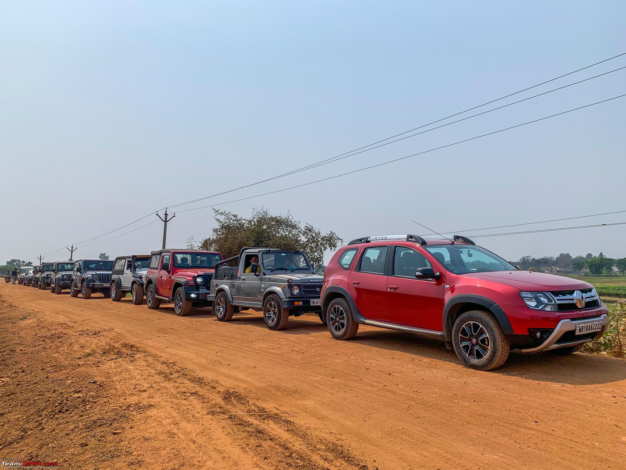

Duster AWD among a sea of SUVs.

.. This event had a lots of driving through water and slush..
Hi Samba, love the way you are putting the Duster to good use.
One thing about water crossings through.. Water crossings always create more issues than worth doing it. Though not immediate effects, gradual effects also create so much headache. Like failing starter, alternator, wheel bearing issues, CV Joints etc etc...
You can not diagnose where water is and prevent the damage. Especially since its a beautiful car and you plan on using it daily, I'd suggest avoid water.. Completely.
Thanks Dhanush.
I 100% agree with you. I generally try to avoid waterlogged streets too.
This otr was supposed to happen on a dry riverbed, & a lot of driving on the sand was expected.
A week prior to the otr when the recce was done, the water level was quite low. But unfortunately a couple of days before the otr it rained, and the water level increased. Even we were a bit surprised!
Now to reach the otr location, we had no other options left other than crossing this portion of the river. And on top of it the sand was wet & slushy.
Had I known this earlier, by no means I would have taken the Duster, I would have taken a jeep for the OTR.
After the otr the Duster got a thorough washing by opening all the four wheels, but it still hurts.
