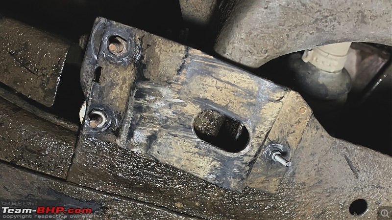

Apart from this, i used the lock at a place which was filled with big boulders and rocks.
While negotiating the big boulders the car scrapped twice or thrice. Luckily there was no major damage apart from two small bolts, which came off, from this bracket. This is a protective bracket placed at the bottom of the shockabsorber and can be used to jack up the car too. As of now, i have totally taken it off. Will get it fixed soon.
This is at the left side.
Renault Duster AWD : An owner's point of view-img_1861.jpg
Attaching the pic of the same bracket on the right side, just for reference.
Renault Duster AWD : An owner's point of view-img_1865.jpg

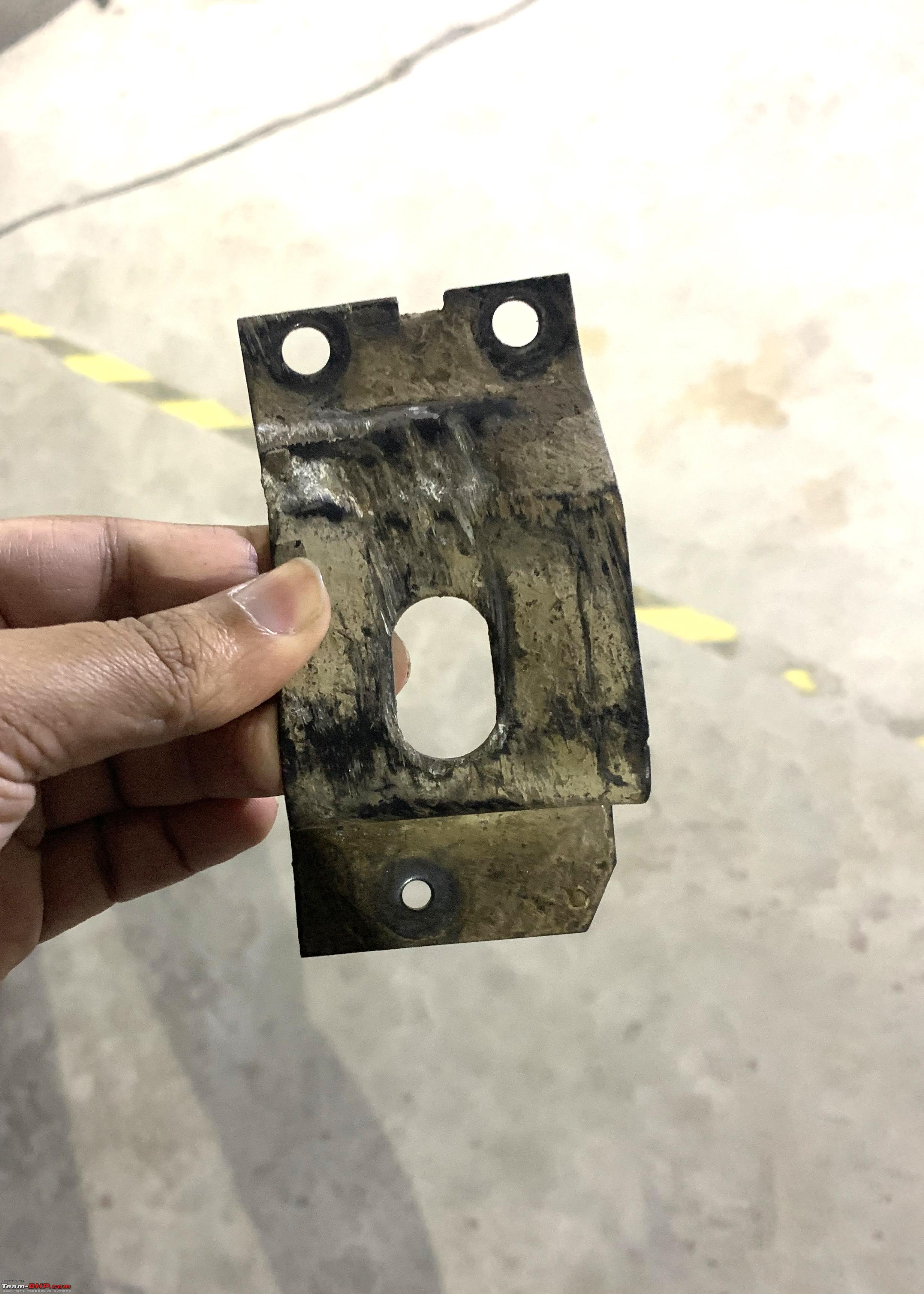

Gave some necessary attention to the Duster after the Sandakphu trip.
In my last post, i mentioned two bolts fell from this protective bracket.
Renault Duster AWD : An owner's point of view-1-2.jpg
So got it fixed with 3 new bolts from Automate Kolkata at Rajarhat. Finding the bolts were a bit difficult, as the exact size was not matching. They took the bracket and went to a nearby shop, matched the size of the bolts & then fixed it. Thanks to them for giving so much time for this minor work.

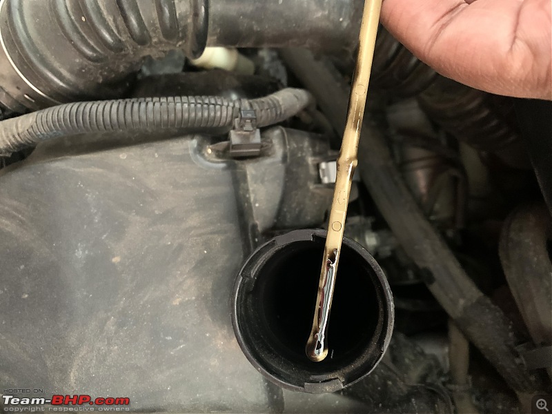

Checked the engine oil level. It's 7,000 km since the oil change. I sent this pic to Ranault & they confirmed, this much dip in level is fine in a cold engine. This can easily do another 3,000 km. Still, i will keep a check on it at every 500 km.

As a make shift arrangement, they have used a much smaller thickness of bolts and nuts and affixed the plate with washers which is fair. Their Extra length might play foul in the long run. Suggest to find the correct bolt and nut for it or just get it riveted which is always a better option. Kudos on the accomplishment !!

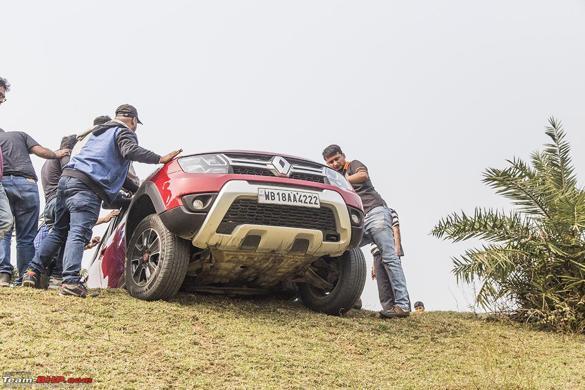

Monocoque cross-overs have a very limited wheel articulation. Wheels tend to get airborne much earlier than the body on frame suv's.
Taking an obstacle like this, where we need to come down in a bit angular way is not much confidence inspiring. With a body on frame Suv & a proper 4L we can just steer it out by not touching the A, B & C pedals. Here we need to modulate the brake with a perfect balance like, we do not lock the wheel, yet we control the speed.
The rear right wheel was airborne in the below pic.
Renault Duster AWD : An owner's point of view-img_1533.jpg
Checkout the limited articulation.
Renault Duster AWD : An owner's point of view-img_1537.jpg

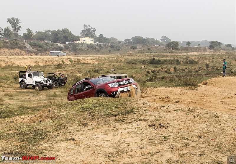

Few pics from the OTR-
Renault Duster AWD : An owner's point of view-img_1510.jpg
Renault Duster AWD : An owner's point of view-img_1690.jpg
Renault Duster AWD : An owner's point of view-img_1707.jpg
Renault Duster AWD : An owner's point of view-img_1772.jpg
Oh yes, I was happy with my Duster!
