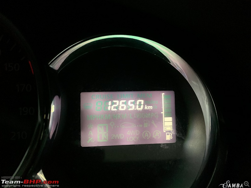

Odo reads 29,000 km, & Duster is back from a 1265 km road trip from Puri

Did a mileage test.
I drove for 70 km with AC on, ECO mode off and the speedometer not exceeding 80 km/hr with two people on board including the driver. This was tested 100% on the highway.
The average speed maintained was 65 km/hr.
Duster returned a phenomenal mileage of 24+ km/L!
