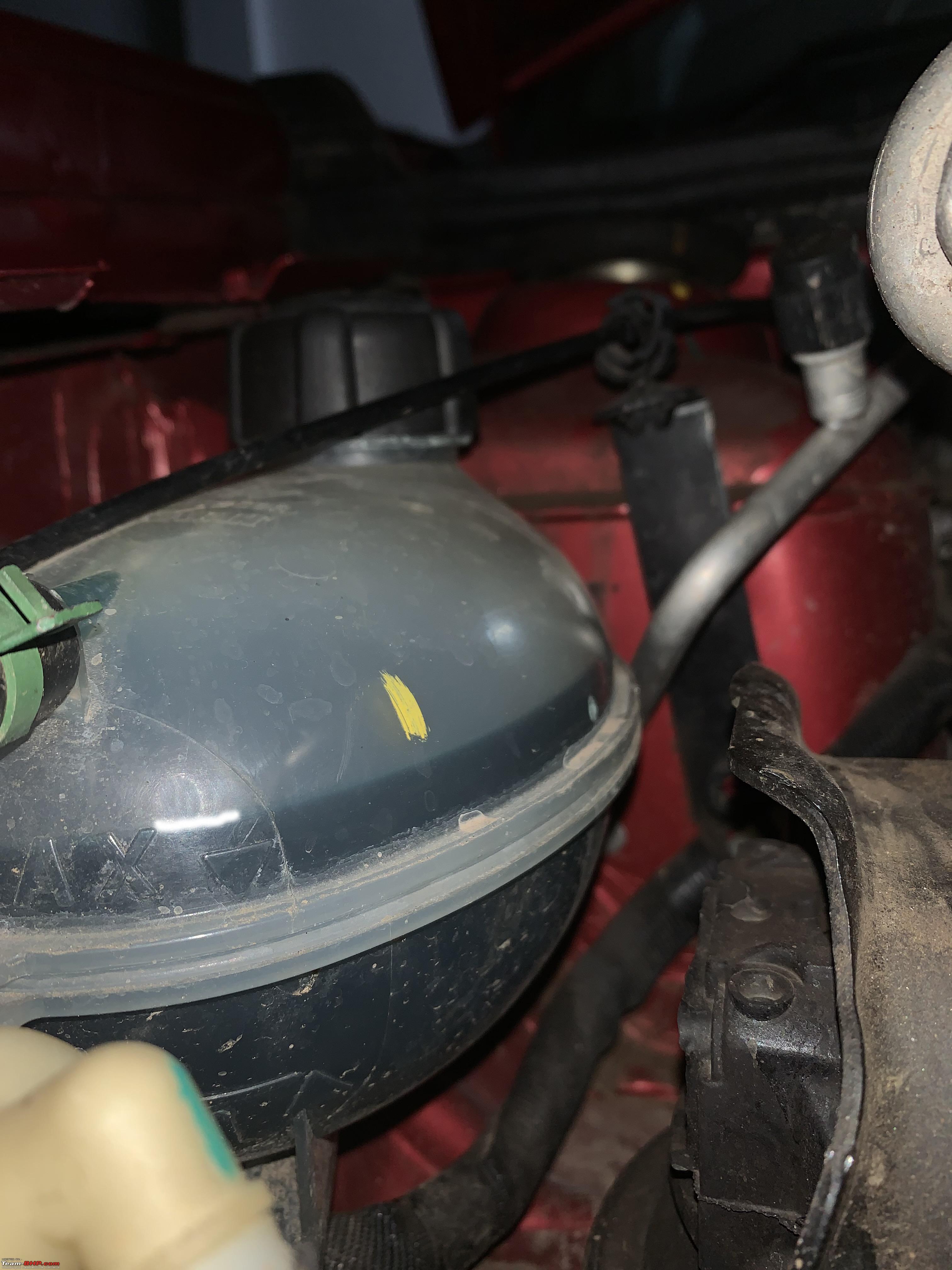

Update on my car. Odo reads 21,250 km
Meanwhile am waiting for the guessed spare (EGR cooler) to arrive from Chennai. Once the spares arrives, I will take my car to get the coolant consumption rectified. As of now, am driving by topping up the coolant, whenever it comes down to 'Min' mark.
In last 930 km of driving, the coolant level again came down to min from the max level.

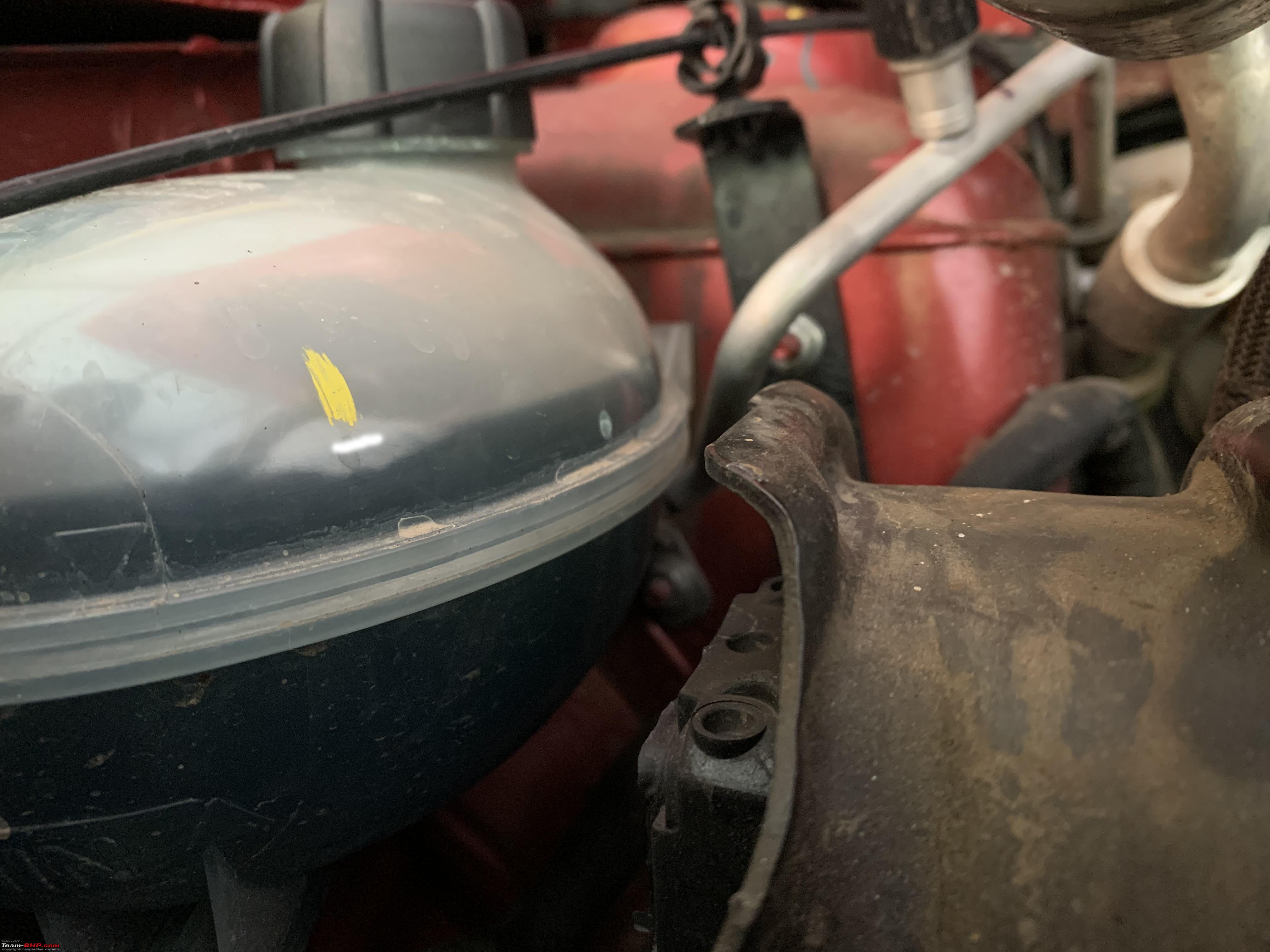

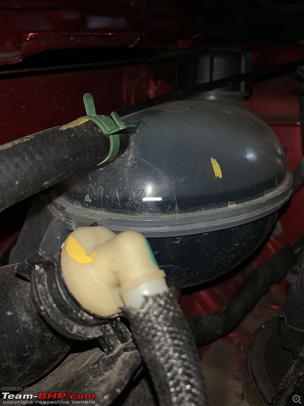

Before changing the EGR cooler, the below points were checked-
No leak from radiator or hoses.
Coolant container is fine, so is the cap.
Engine oil & coolant both for contamination. All were clean.
Coolant thermostat valve is also fine.
There is no leakage from static car.
Drove around 750 km after the EGR change.
Attaching few pics of the coolant consumption after top up.
I have marked the level with a white line, so comparing the level by noticing the yellow mark and the 'X' of the 'MAX' mark as a reference will be easy.
After top-up.
Renault Duster AWD : An owner's point of view-160-1.jpg
After 160 km
Renault Duster AWD : An owner's point of view-160-2.jpg
Next day before the drive
Renault Duster AWD : An owner's point of view-170-2.jpg
After 170 km drive
Renault Duster AWD : An owner's point of view-171.jpg
On another day before the drive
Renault Duster AWD : An owner's point of view-385-1.jpg
After 385 km drive
Renault Duster AWD : An owner's point of view-385-2.jpg
All the pics were taken while the engine was cold. If we notice from the 1st pic till the last pic, in this 700+ km, atleast the car has consumed around 200 ml coolant. Check out the yellow marking for reference.

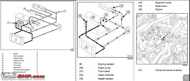

I have heard of many cars having a drinking problem, but it's usually been fuel or engine oil. This is quite an uncommon and intriguing drinking problem, I must say.
So I pulled out some manuals to look at the cooling circuit of the K9K engine, and here's what I found.
Renault Duster AWD : An owner's point of view-duster-k9k-cooling-circuit.jpg
From your description, the service centre seems to have addressed most of the issues where coolant loss can be suspected. That leaves out a few things that need to be looked into:
1. The oil-water heat exchanger. Maybe there's such a minor leak, the coolant isn't contaminating the engine oil enough to cause a colour change.
2. The cabin heater radiator. Hidden inside the dashboard, a minor leak can go unnoticed.
3. The expansion bottle pressure cap. Swap it out with another Duster, and check after a few hundred km.
4. The head gasket. A hairline cut / crack in the head gasket might bleed coolant from the cooling circuit directly into the upper cylinder, and from there to the exhaust. Perhaps happening only in a hot engine at high revs. The loss would be so minor that no one would notice the smoke, and there would be no telltale mark of coolant leakage either.
It would be interesting to learn what is actually causing this drinking problem!

Since then I drove for 300 km and to my relief the coolant level is not dipping any further.

After 300 km
Renault Duster AWD : An owner's point of view-img_4977.jpg
Earlier after 300 km the drop in the coolant level was easily spotted. Now the level is not dipping anymore. (Post no 126 on this thread can be checked for reference.) So am hoping that the problem is finally resolved. Fingers crossed.

Hey Samba , maybe it is the pic, isnt your coolant level above the max threshold line?
Could there be any sideeffects due to overfilling?
