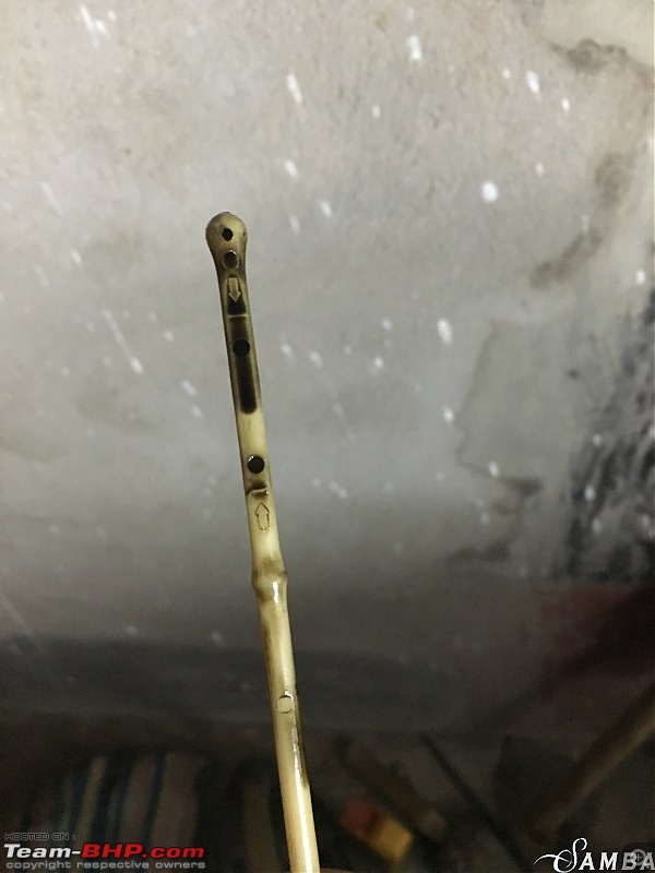

Checked the dip stick yesterday to see the condition of the engine oil.
There is a slight dip in level after driving for nearly 10,000 km. This seems to be normal before the first oil change in a new diesel engine.

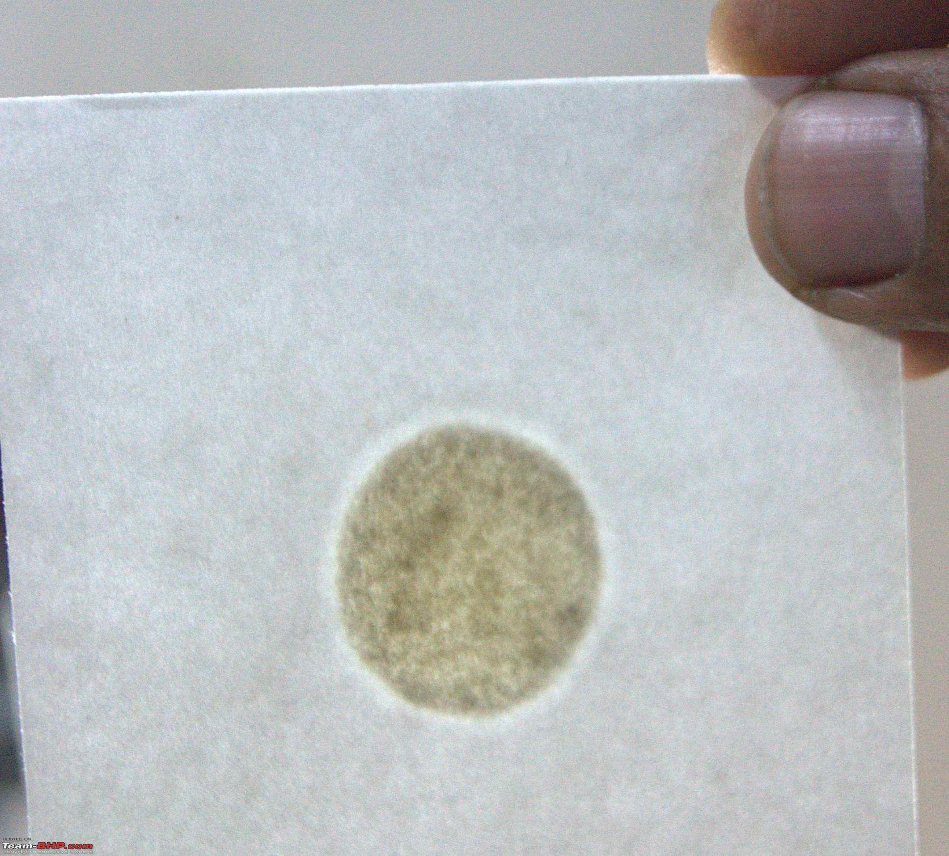

Got the blotting paper test done for the engine oil yesterday.
Renault Duster AWD : An owner's point of view-img_0813.jpg
The procedure was beautifully explained by D-Bhpian SS-Traveller.
The first test (and a very simple one at that) that I am introduced to, is the Blotting Paper Test. A drop of oil is placed on a Whatman filter paper which is suspended over a beaker, and allowed to be absorbed over about 2 hours. The blot that forms is studied for size, the black deposits in the middle, and the ring(s) that form around it.
Attachment 1554079
The oil blot is held up against light and studied
Attachment 1554080
[left]
The interpretation is as follows:
- A colourless or slight yellow spot: new or very slightly used oil.
- Evenly dispersed black deposits (as seen here): used oil that still has good life left in it
- A dense, dark zone in the centre where the black deposits clump together: The oil has reached the end of its useful life
- A dark center with brownish outer ring: Severely oxidized oil
- A dark center with surrounding rings: Fuel in oil
From the above explanation, it looks like the oil is reaching the end of it's life. The center still do not have a dark zone but looks like, its on the way. So at max this oil is good to go for another 500 km. Am getting it changed before driving more than 100 km itself.

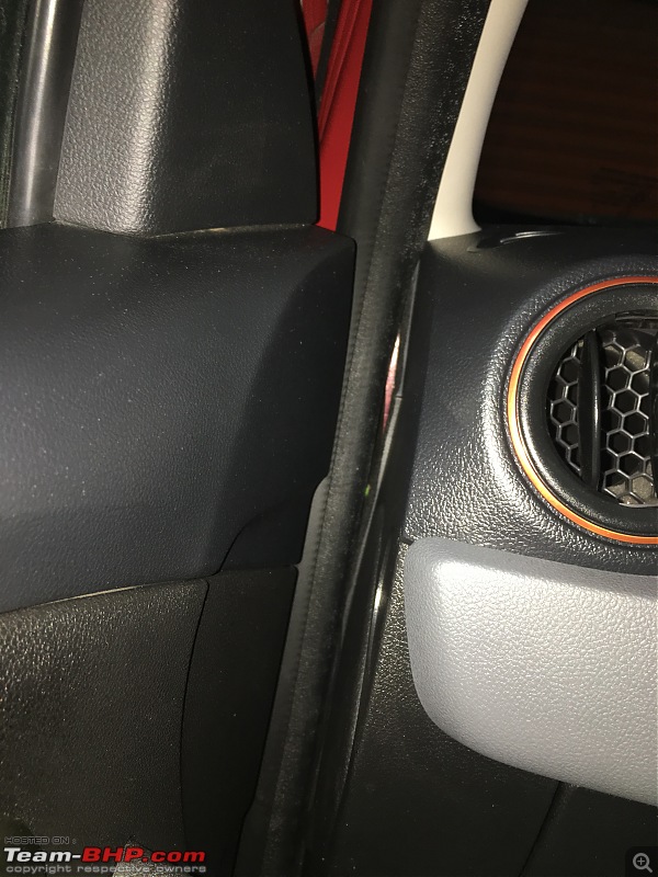

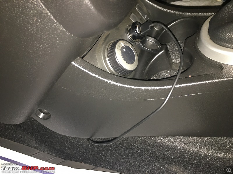

Finally managed to conceal the charging cable of the dash-cam.
Thanks to Bhpian PapaBravo for showing me an easy method to do this DIY without opening the plastic panels.
The easy 5-10 minutes procedure!
Tool used was just a screw driver.
Inserted the cable inside the ceiling.
Renault Duster AWD : An owner's point of view-1.jpg
Took it out and inserted it inside the rubber beading.
Renault Duster AWD : An owner's point of view-2.jpg
Renault Duster AWD : An owner's point of view-3.jpg
It was a bit difficult to insert the cable inside the rubber beading beside the dashboard as the space to insert the screwdriver was very less, but with a bit of patience i managed it.
Renault Duster AWD : An owner's point of view-4.jpg
Took the cable from behind the lower part of the dashboard and tied it with the other cables.
Renault Duster AWD : An owner's point of view-5.jpg
Renault Duster AWD : An owner's point of view-6.jpg
The final look.
Renault Duster AWD : An owner's point of view-7.jpg
Renault Duster AWD : An owner's point of view-8.jpg

I think it would have been a little more better if you keep the wire inside the plastic covering on the A pillar. I believe the rubber beading is easily removable by just pulling it and the plastic covering can be easily pulled out. After that you could direct the wire to lower dashboard area through the space available at the A pillar - dashboard meeting area.
Note: I used to do the same when ever I feel to damp the plastic parts, in case of any rattles in my Honda City.

Yes, i agree that's the proper way. Actually, i was a bit skeptical to open the company fitted parts. I was thinking, if i fiddle more with these parts they will start rattling earlier! That's the sole reason i left it intact. They are on plastic clips, if they become lose it might rattle.
