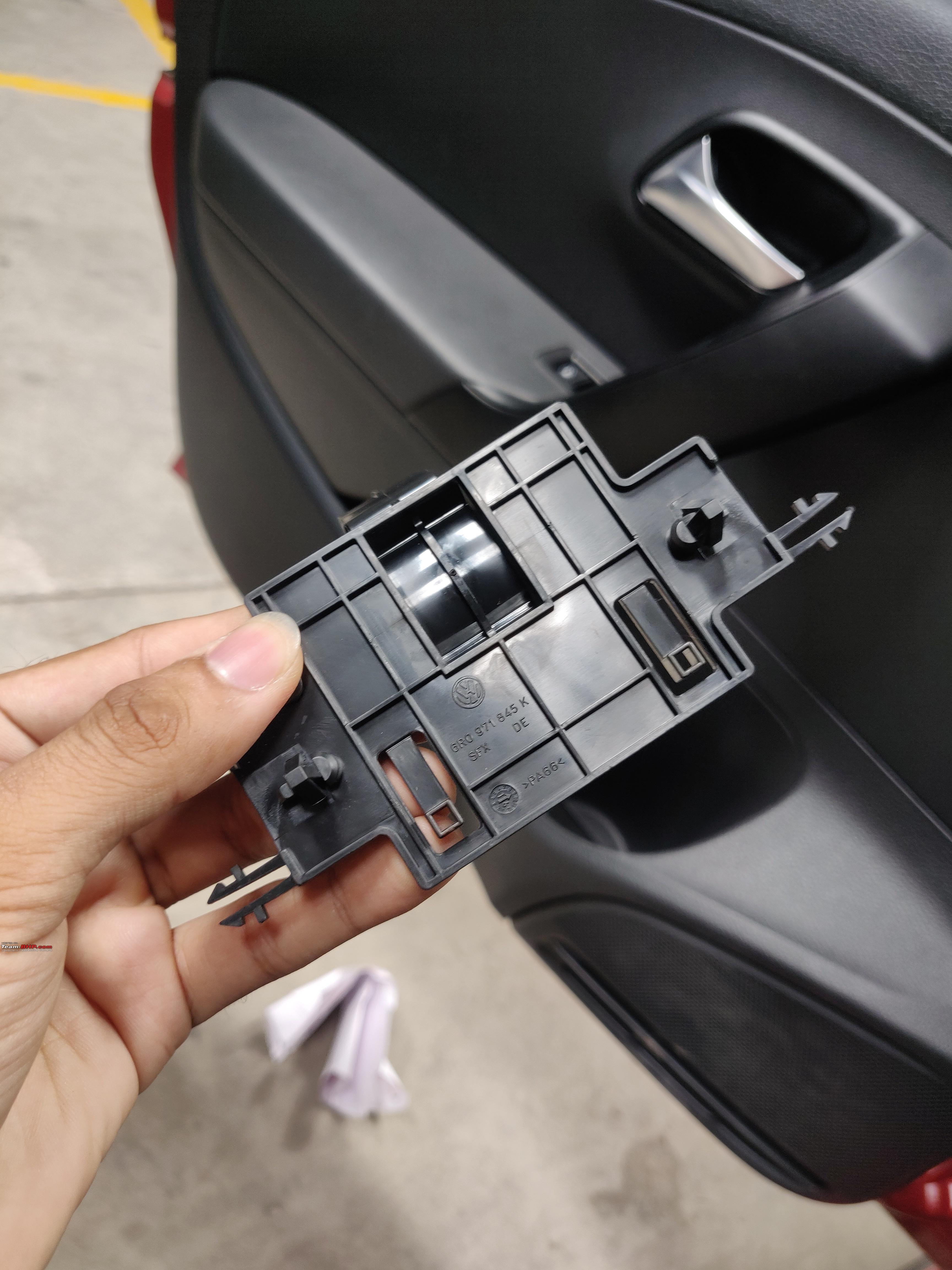

Seat Plates
The Polo and Vento platform have smaller seat-rails compared to the PQ35 Jetta, Laura and the elder sibling Superb. So the Superb seats weren't a straight mechanical swap in the Polo and might have either needed drilling in the chassis, or some mechanical fixtures to install in the Polo. Prerak spent a lot of time to perfect these Seat plates and sent me a set of these adapters. I highly recommend buying these adapters from him if you want to do a similar project. In fact, Prerak had flown in to help me install these seats. That was when I got to meet him in person for the first time, but more on that later.
Review: Driving home our Sunset Red VW Polo Highline+ TSI Automatic-seat-plate-overview.jpg
Review: Driving home our Sunset Red VW Polo Highline+ TSI Automatic-seat-plate-closeup.jpg
Review: Driving home our Sunset Red VW Polo Highline+ TSI Automatic-seat-plates-marked-welded-studs.jpg
Review: Driving home our Sunset Red VW Polo Highline+ TSI Automatic-spray-painted-electric-seat-plates.jpg

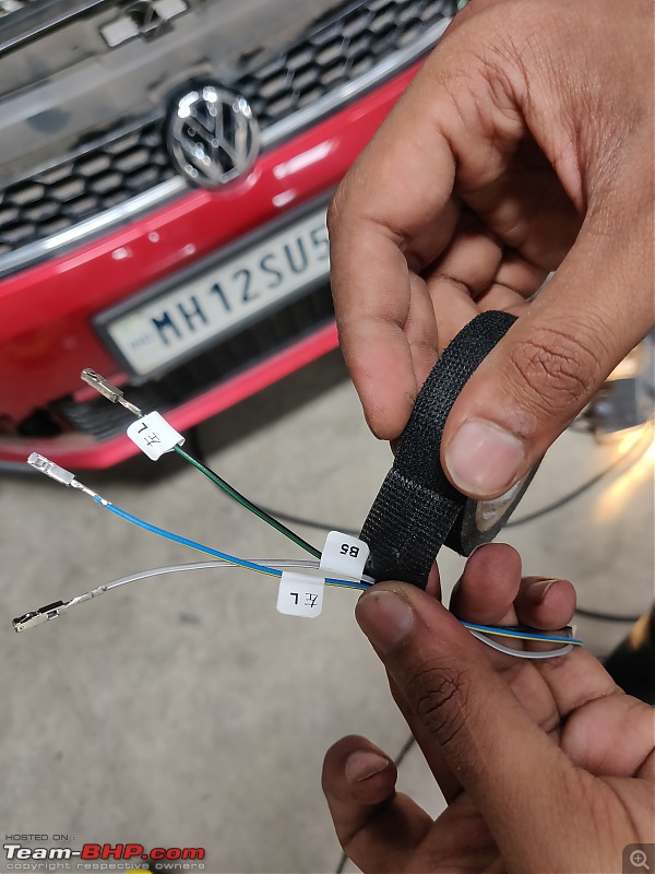

Next, the Bi-xenon headlights were wired to the proper T10 to T14 adapter, with inputs to the BCM for controlling the DRLs and cornering lights. Again, Prerak and Hrithik helped me wire in the last few connections to the BCM since they were a lot more flexible than I was back then
Review: Driving home our Sunset Red VW Polo Highline+ TSI Automatic-img20220912wa0009.jpg
Review: Driving home our Sunset Red VW Polo Highline+ TSI Automatic-t10-t14.jpg
Review: Driving home our Sunset Red VW Polo Highline+ TSI Automatic-taping-some-headlight-harnesses.jpg

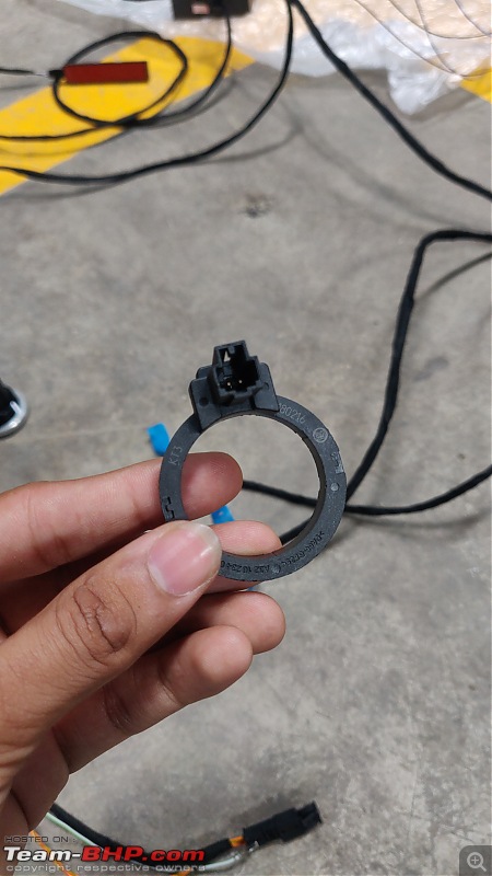

AFS Wiring Connector
A new AFS module was being installed, and the location was decided to be behind the passenger glovebox. The module latches onto such a bracket.
Review: Driving home our Sunset Red VW Polo Highline+ TSI Automatic-afs-module-holder-polo-6r.jpg
Review: Driving home our Sunset Red VW Polo Highline+ TSI Automatic-afs-module-mounting-bracket-rear-side.jpg
The T32 connector was assembled to connect the AFS Module.
Review: Driving home our Sunset Red VW Polo Highline+ TSI Automatic-constructing-afs-wiring-t32.jpg
The AFS sensor sits on the rear axle, and the wire passes under the rear seat bench. Naturally, the wiring plug is weatherproof and has a rubber boot.
Review: Driving home our Sunset Red VW Polo Highline+ TSI Automatic-afs-sensor-wiring-plug.jpg
Review: Driving home our Sunset Red VW Polo Highline+ TSI Automatic-seat-grommet-afs-sensor-wiring.jpg

PQ25 Kessy Retrofit
Review: Driving home our Sunset Red VW Polo Highline+ TSI Automatic-polo-6r-kessy-kit-overview.jpg
This was another exciting feature which became popular in India, and it seemed to work really well. So I bit the bullet and procured a PQ25 KESSY kit. A retrofit that seemed to level-up the capabilities of the Polo, but had its share of complications.
Review: Driving home our Sunset Red VW Polo Highline+ TSI Automatic-polo-6r-kessy-handles-painted.jpg
Review: Driving home our Sunset Red VW Polo Highline+ TSI Automatic-kessy-elv-connector.jpg
It used a few aftermarket modules, and needed some wire changes, which would need huge wire cutting around the ignition switch, along with proper adaption of a few used tools, like the ELV.
Review: Driving home our Sunset Red VW Polo Highline+ TSI Automatic-key-detector-ring.jpeg
Review: Driving home our Sunset Red VW Polo Highline+ TSI Automatic-kessy-connector-block.jpg
Review: Driving home our Sunset Red VW Polo Highline+ TSI Automatic-kessy-antenna.jpg
Review: Driving home our Sunset Red VW Polo Highline+ TSI Automatic-kessy-t32-sleeve.jpg
For a car that needs to be reliable for daily driving, I decided to pause this retrofit, and never ended up fully installing it. All I did, was lay in the wiring. and recently, I had it taken out, so I could give it to a friend, who will surely install it.

Making Wirings, Catching Feelings
Review: Driving home our Sunset Red VW Polo Highline+ TSI Automatic-polo-retrofit-wiring-preparation.jpg
I've made plenty of retrofit wirings from scratch for this car, and they've all taught me so much about VW cars.
Review: Driving home our Sunset Red VW Polo Highline+ TSI Automatic-crimping-tool.jpg
Definitely an experience of a life-time for me. It is sheerly because of these beautiful experiences, modifying this car, that I've felt a stronger connect with this brand, not to forget, the brilliant driving experience, and the grunt from this 1.0 TSI! I've no regrets for wanting to push the PQ25 platform to its limits, and even though I couldn't do everything I once sought to, looking back, I've actually done quite a lot of stuff, and this thread will be a testimony to those milestones that I can look back onto.
