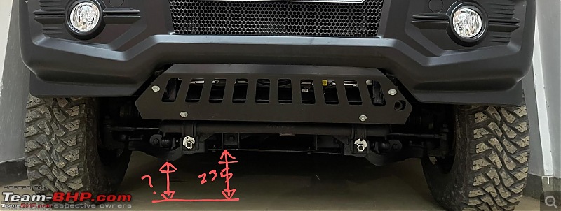

Vignesh-ji, I have marked a certain portion in the attached photo of section of your car, did you measure this? Whether it is less than 235 mm or almost equal or more?

The middle portion of my truck ( under my modified bash plate is 235 mm+)
As we move closer to the wheel, the control lower arms are about 205 mm and lower at the bend of the arm)
See the few pictures above few posts earlier for the measurements at both these places.
Hope it helps!

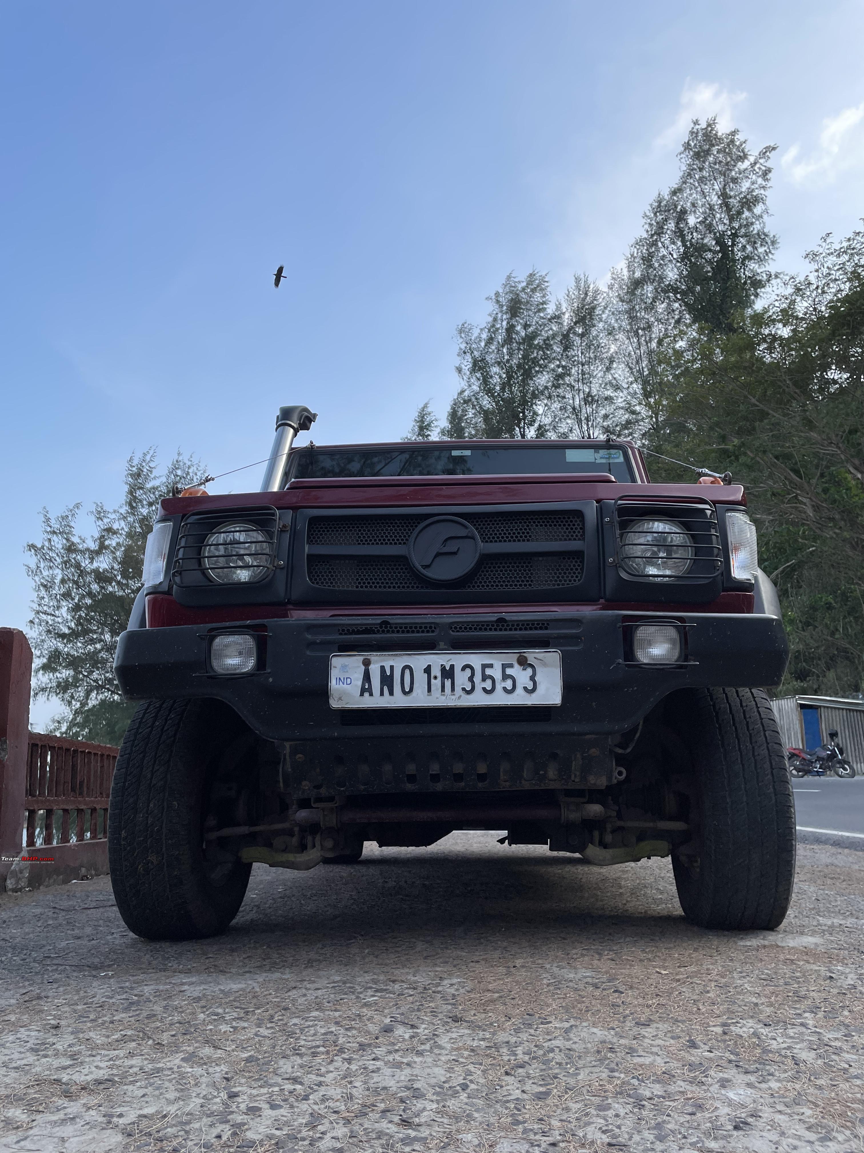

The lower arms were at similar height in the older Gurkha also , regardless of hit or not.
I have raised the bash plate to highest point possible.
The arms are lower but don’t hit like the lower bash used to .
